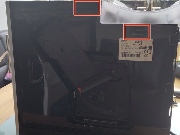

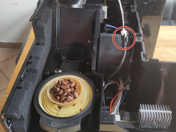

  4. Disassembly of the Melitta Caffeo CI housing: crwdns2935265:04crwdnd2935265:01crwdnd2935265:03crwdne2935265:0 Disassembly of the Melitta Caffeo CI housing: crwdns2935265:04crwdnd2935265:02crwdnd2935265:03crwdne2935265:0 Disassembly of the Melitta Caffeo CI housing: crwdns2935265:04crwdnd2935265:03crwdnd2935265:03crwdne2935265:0
    • Please read all the points in this step before removing the clips.
    • There are three clips on the side of the water tank. Two of them are marked in the first picture. The third clip is to the left of the two clips.
    • There are two clips on the other side. See the second picture.
    • Start removing the clips from the back using a flat screwdriver. Lift the cover slightly as you do so. Insert the screwdriver as steeply as possible into the slots from above and then lever it up. The side panels remain attached to the machine. The cover is also connected to a cable, so lift it carefully.
    • Disconnect the cable plug and remove the cover completely. The plug has a small lock; press the hook down.

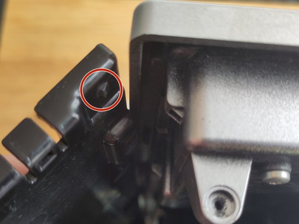

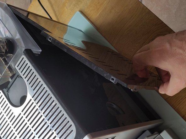

    • First remove the right side panel, as is has no other cables or hoses connected to it.
    • There are tabs at the bottom of the side panel, so you have to pull the side panel backwards. You cannot pry it off.
    • There are smaller tabs on the front. The upper one can be loosened with a small flat screwdriver. This may make it easier to remove the side panel.
    • Pull the side panel firmly but carefully toward the rear. It can then be removed completely.

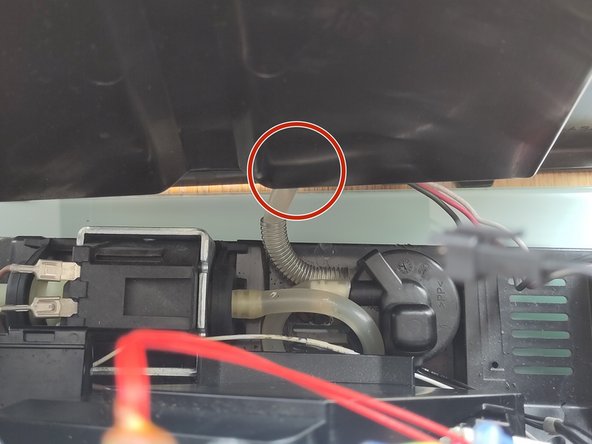

  6. Disassembly of the Melitta Caffeo CI housing, Remove the left side panel: crwdns2935265:06crwdnd2935265:01crwdnd2935265:03crwdne2935265:0 Disassembly of the Melitta Caffeo CI housing, Remove the left side panel: crwdns2935265:06crwdnd2935265:02crwdnd2935265:03crwdne2935265:0 Disassembly of the Melitta Caffeo CI housing, Remove the left side panel: crwdns2935265:06crwdnd2935265:03crwdnd2935265:03crwdne2935265:0

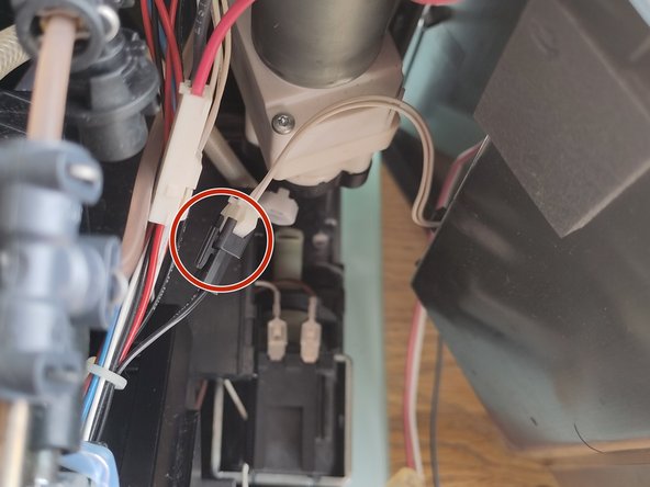

    • The same procedure applies as for the other side panel. Here, you just need to make sure that there are still two cable connections and one hose connection. Detach the side panel as described above, but leave it close to the housing.
    • Disconnect the plug with the red, white, and black cables from the circuit board. It has a small hook that you have to press in.
    • Disconnect the water hose at the end that is attached to the side panel
    • Disconnect the black and white plug; is has a small lock.
    • The side panel can now be completely removed.
