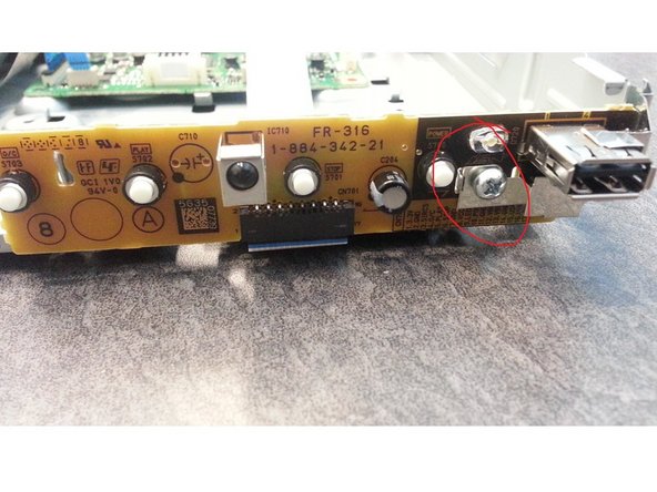

    • Now depress metal tab to fully remove heat sink clamp.
  10. Disassembly of Sony BDP-BX18 Blue-Ray player: crwdns2935265:010crwdnd2935265:01crwdnd2935265:02crwdne2935265:0 Disassembly of Sony BDP-BX18 Blue-Ray player: crwdns2935265:010crwdnd2935265:02crwdnd2935265:02crwdne2935265:0
    • Pull on indicated ribbon cable to begin removal of front display.
    • Now remove single screw to remove front display panel.

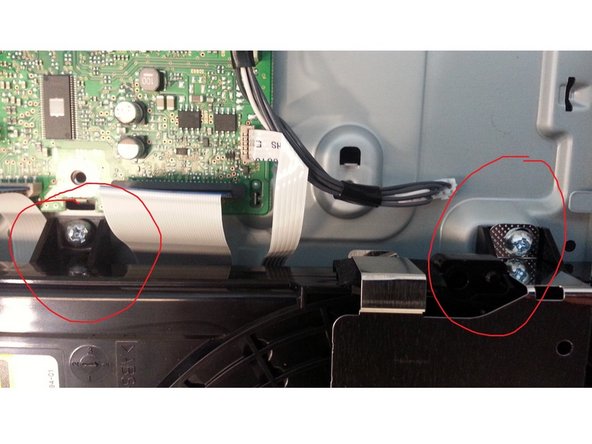

  12. Disassembly of Sony BDP-BX18 Blue-Ray player: crwdns2935265:012crwdnd2935265:01crwdnd2935265:02crwdne2935265:0 Disassembly of Sony BDP-BX18 Blue-Ray player: crwdns2935265:012crwdnd2935265:02crwdnd2935265:02crwdne2935265:0
    • Next, remove all three ribbon cables attached to optical disc drive.
    • *NOTE: largest ribbon cable has small secure clamp, be sure to release it before pulling.
    • Now unscrew both mounting screw for optical disc drive for complete removal.

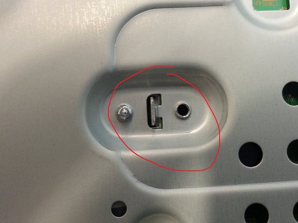

  13. Disassembly of Sony BDP-BX18 Blue-Ray player: crwdns2935265:013crwdnd2935265:01crwdnd2935265:01crwdne2935265:0
    • To completely remove the main board, locate screws on back of unit. Unscrew these 2 screws and then slide main board out.

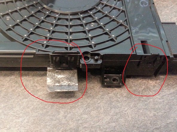

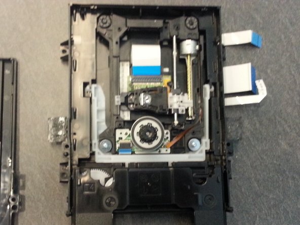

  15. Disassembly of Sony BDP-BX18 Blue-Ray player: crwdns2935265:015crwdnd2935265:01crwdnd2935265:03crwdne2935265:0 Disassembly of Sony BDP-BX18 Blue-Ray player: crwdns2935265:015crwdnd2935265:02crwdnd2935265:03crwdne2935265:0 Disassembly of Sony BDP-BX18 Blue-Ray player: crwdns2935265:015crwdnd2935265:03crwdnd2935265:03crwdne2935265:0
    • First remove metal shroud exposing tabs.
    • Peel back security tape and release all 4 tabs (2 on each side) for removal of top cover.
    • Now the internal components of the optical disc drive are now exposed.

Hi! I have just a quick question! The front display panel of my Sony Blu Ray player had broken! The small board with the USB mounted onto it, remote sensor and buttons! What is the name of this board? I was looking to order a replacement
