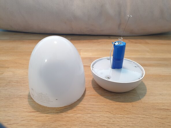

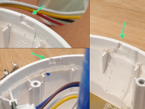

    • The luminous screen is connected to the lower part via a bayonet lock, see green arrows in Figure 1. In addition, the luminous screen is sealed to the lower part by a silicone seam.
    • Hold the lower part with one hand and turn the upper part - the luminous screen - counterclockwise to unlock the bayonet lock.
    • Lift the luminous screen and remove it.

  4. Disassembly Mediacous ME-NL02 Nightlight Egg, disassembled state: crwdns2935265:04crwdnd2935265:01crwdnd2935265:01crwdne2935265:0
    • luminous screen
    • 3x Phillips screw
    • antenna for touch function of the luminous screen
    • battery
    • LED bulbs
    • circuit board with press button
    • main circuit board
Reverse the steps to reassemble your device.
