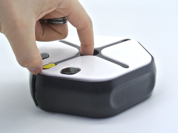

    1. Disassembling the Root Coding Robot, Removing the bottom screws: crwdns2935265:01crwdnd2935265:01crwdnd2935265:01crwdne2935265:0
      • The first step in our disassembly is to remove the four bottom Phillips screws.

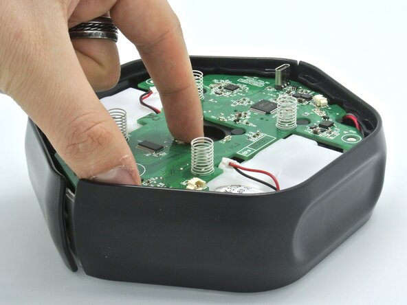

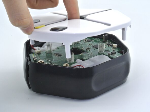

    2. Disassembling the Root Coding Robot, Opening up the Root: crwdns2935265:02crwdnd2935265:01crwdnd2935265:03crwdne2935265:0 Disassembling the Root Coding Robot, Opening up the Root: crwdns2935265:02crwdnd2935265:02crwdnd2935265:03crwdne2935265:0 Disassembling the Root Coding Robot, Opening up the Root: crwdns2935265:02crwdnd2935265:03crwdnd2935265:03crwdne2935265:0

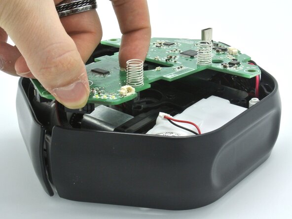

      • Once the screws are removed, simply flip the robot face up and lift the top cover. This will expose the Root's motherboard.
    3. Disassembling the Root Coding Robot, Disconnecting some cables: crwdns2935265:03crwdnd2935265:01crwdnd2935265:03crwdne2935265:0 Disassembling the Root Coding Robot, Disconnecting some cables: crwdns2935265:03crwdnd2935265:02crwdnd2935265:03crwdne2935265:0 Disassembling the Root Coding Robot, Disconnecting some cables: crwdns2935265:03crwdnd2935265:03crwdnd2935265:03crwdne2935265:0
      • Remove the three screws holding the motherboard in place.
      • With a spudger, remove the four cables connected to the motherboard. This will allow us to lift it but there's still a couple of connectors to disconnect.
      • Don't force the motherboard out as the erasing mechanisms and color sensors are still connected to it.

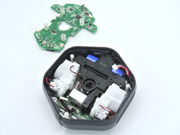

    4. Disassembling the Root Coding Robot, Removing the motherboard: crwdns2935265:04crwdnd2935265:01crwdnd2935265:02crwdne2935265:0 Disassembling the Root Coding Robot, Removing the motherboard: crwdns2935265:04crwdnd2935265:02crwdnd2935265:02crwdne2935265:0
      • Now you can see both connectors still attached to the motherboard, remove them and simply set the motherboard aside.
    5. Disassembling the Root Coding Robot, Side buttons: crwdns2935265:05crwdnd2935265:01crwdnd2935265:02crwdne2935265:0 Disassembling the Root Coding Robot, Side buttons: crwdns2935265:05crwdnd2935265:02crwdnd2935265:02crwdne2935265:0
      • With the motherboard out of the way, we can simply lift the side buttons and remove them.

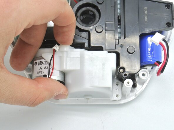

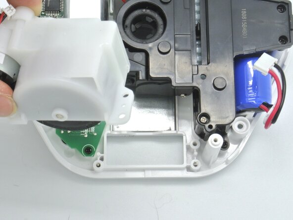

    6. Disassembling the Root Coding Robot, Motors: crwdns2935265:06crwdnd2935265:01crwdnd2935265:03crwdne2935265:0 Disassembling the Root Coding Robot, Motors: crwdns2935265:06crwdnd2935265:02crwdnd2935265:03crwdne2935265:0 Disassembling the Root Coding Robot, Motors: crwdns2935265:06crwdnd2935265:03crwdnd2935265:03crwdne2935265:0
      • Without the side buttons we can now easily access the three Phillips screws holding down the motors.
      • Unscrew them and remove the motors.

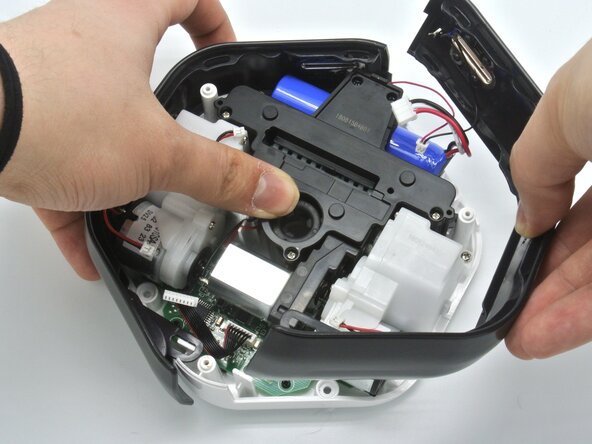

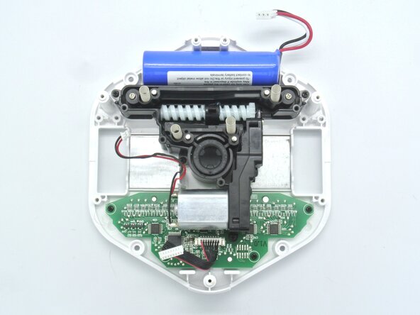

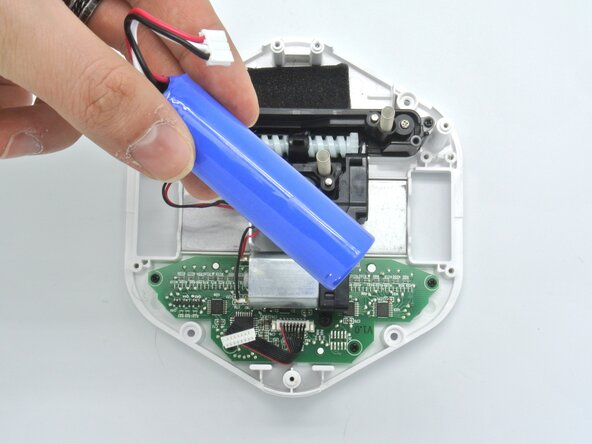

    7. Disassembling the Root Coding Robot, Accessing the battery: crwdns2935265:07crwdnd2935265:01crwdnd2935265:02crwdne2935265:0 Disassembling the Root Coding Robot, Accessing the battery: crwdns2935265:07crwdnd2935265:02crwdnd2935265:02crwdne2935265:0
      • To access the battery, unscrew the 6 Phillips screws and remove the plastic piece.
      • With motors removed you can now see thge powerful magnets that hold this robot fixed on a whiteboard.
    8. Disassembling the Root Coding Robot, Battery: crwdns2935265:08crwdnd2935265:01crwdnd2935265:02crwdne2935265:0 Disassembling the Root Coding Robot, Battery: crwdns2935265:08crwdnd2935265:02crwdnd2935265:02crwdne2935265:0
      • With access to the battery, you can simply take it out.

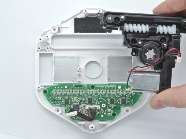

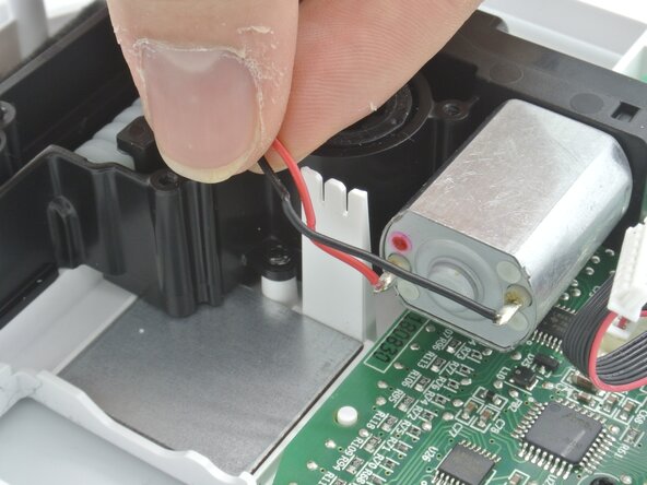

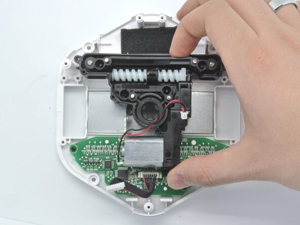

    10. Disassembling the Root Coding Robot, Erasing mechanism: crwdns2935265:010crwdnd2935265:01crwdnd2935265:03crwdne2935265:0 Disassembling the Root Coding Robot, Erasing mechanism: crwdns2935265:010crwdnd2935265:02crwdnd2935265:03crwdne2935265:0 Disassembling the Root Coding Robot, Erasing mechanism: crwdns2935265:010crwdnd2935265:03crwdnd2935265:03crwdne2935265:0
      • The cool thing about the Root robot is that it can go on a white board and it can erase stuff. That mechanism is shown here and it can be remove by unscrewing these four screws.
      • Once that's done, remove the erasing mechanism.

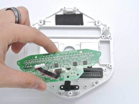

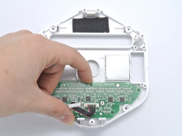

    11. Disassembling the Root Coding Robot, Color sensor board: crwdns2935265:011crwdnd2935265:01crwdnd2935265:03crwdne2935265:0 Disassembling the Root Coding Robot, Color sensor board: crwdns2935265:011crwdnd2935265:02crwdnd2935265:03crwdne2935265:0 Disassembling the Root Coding Robot, Color sensor board: crwdns2935265:011crwdnd2935265:03crwdnd2935265:03crwdne2935265:0
      • To recognize colors, the Root uses a color sensor board at the bottom of the robot. Unscrew the five screws holding the board to the chassis.
      • Remove the board.
