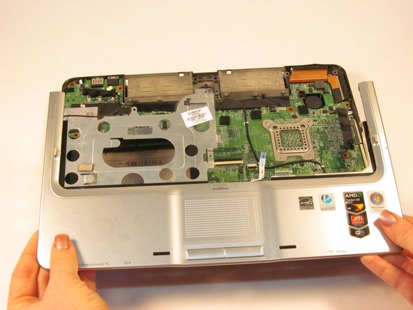

  13. Disassembling the HP Pavilion tx2500 Bezel, Bezel: crwdns2935265:013crwdnd2935265:01crwdnd2935265:03crwdne2935265:0 Disassembling the HP Pavilion tx2500 Bezel, Bezel: crwdns2935265:013crwdnd2935265:02crwdnd2935265:03crwdne2935265:0 Disassembling the HP Pavilion tx2500 Bezel, Bezel: crwdns2935265:013crwdnd2935265:03crwdnd2935265:03crwdne2935265:0
    • Disconnect the wire from the system board using the plastic opening tool.
    • Disconnect the wire from the optical drive using the plastic opening tool.
    • Gently lift the top cover from the tablet.

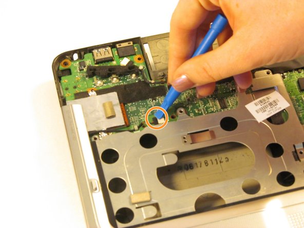

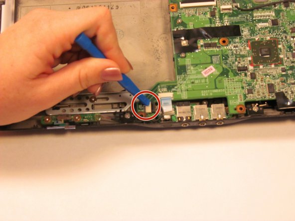

  14. Disassembling the HP Pavilion tx2500 Bezel: crwdns2935265:014crwdnd2935265:01crwdnd2935265:02crwdne2935265:0 Disassembling the HP Pavilion tx2500 Bezel: crwdns2935265:014crwdnd2935265:02crwdnd2935265:02crwdne2935265:0
    • Using the plastic opening tool, disconnect the plastic blue film from the tablet.
    • Disconnect the wire using the plastic opening tool.

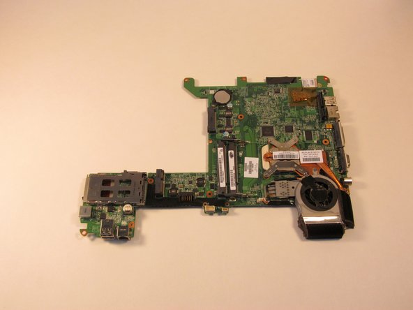

  15. Disassembling the HP Pavilion tx2500 Bezel: crwdns2935265:015crwdnd2935265:01crwdnd2935265:02crwdne2935265:0 Disassembling the HP Pavilion tx2500 Bezel: crwdns2935265:015crwdnd2935265:02crwdnd2935265:02crwdne2935265:0
    • Lift the system board from the tablet.
    • Turn the system board over and lay it flat on a soft surface.
  16. Disassembling the HP Pavilion tx2500 Bezel: crwdns2935265:016crwdnd2935265:01crwdnd2935265:01crwdne2935265:0
    • Gently remove the bezel from the system board.
