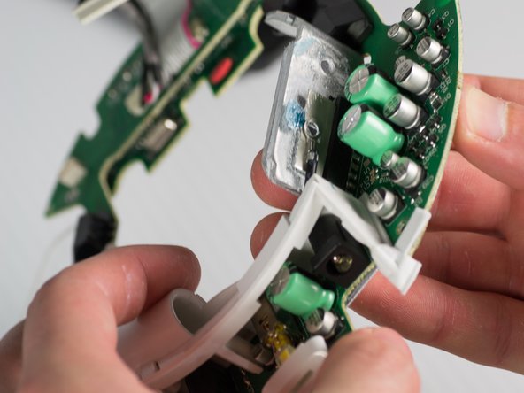

      • Carefully press out the white base tube and push up on the circuit board.
      • Note that there is a small wire connecting the circuit board to the base.

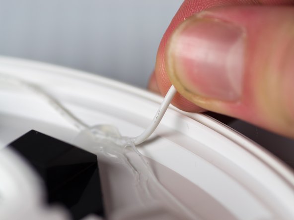

      • Pull the white wire out of the hot glue.

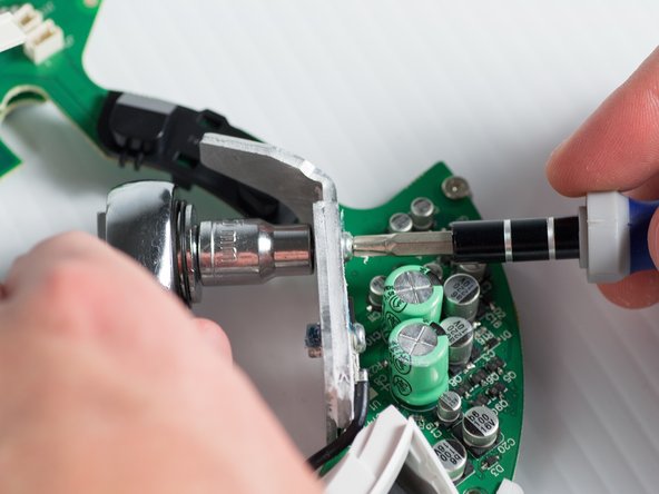

      • Unbolt the heatsink with a 5.5-mm socket and a Phillips PH1 screwdriver.
      • Remove the heat sink; it should detach from the bottom of the device.

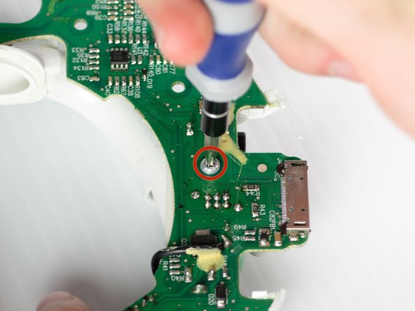

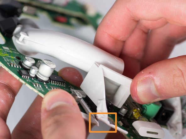

      • Remove the T-10 torx screw on the bottom of the device that attaches the base tube to the circuit board.
      • Turn the device so that the base tube is on top.
      • Remove the base tube by pulling up.
      • May need to cut the rubber adhesive between the base tube to the circuit board.
