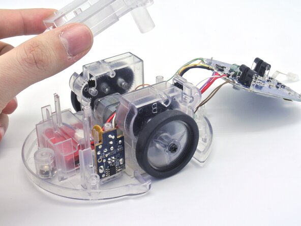

      • To open the Blue-Bot, remove the Phillips M3 screws and lift up the top cover.

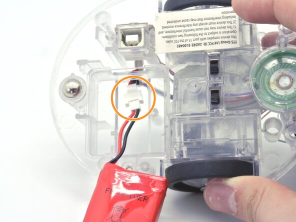

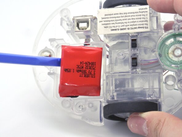

      • On the bottom of the robot, remove the Tri-angle screw.
      • This will reveal the battery that you need to disconnect to remove it.

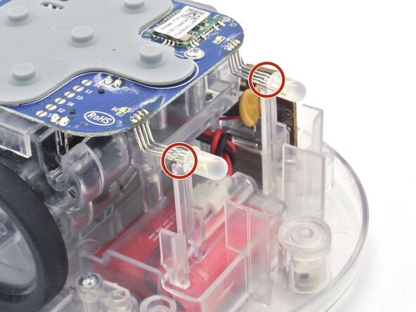

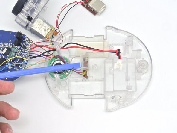

      • Now that the cover is off, we have access to the the PCB but before removing it the LEDs for the eyes are glued on the chassis.
      • With a hairdryer or a heat gun, we can soften the glue to remove it easily.
      • You can also remove the glue by force but you have to be careful to not break the LEDs.

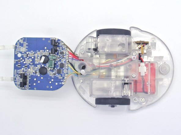

      • The next step is to remove the screws holding the PCB to the chassis.
      • Remove the two M3 screws and simply lift up the PCB.

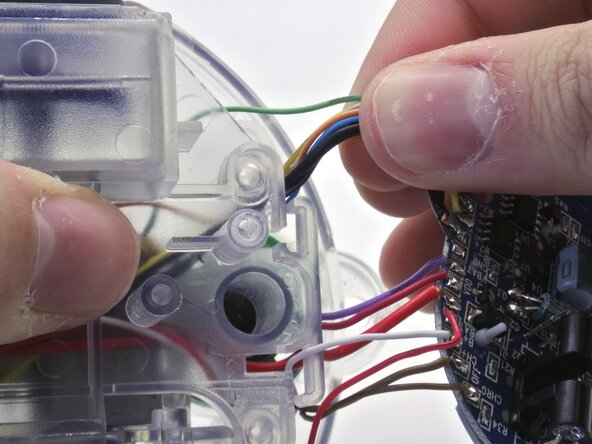

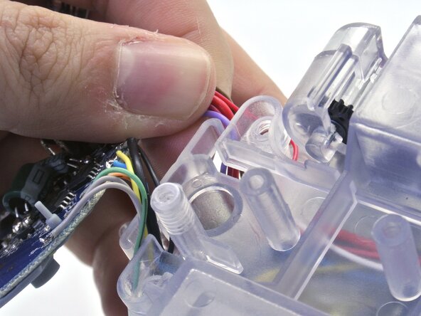

    6. Disassembling the Blue-Bot, Getting the cables out of the way: crwdns2935265:06crwdnd2935265:01crwdnd2935265:03crwdne2935265:0 Disassembling the Blue-Bot, Getting the cables out of the way: crwdns2935265:06crwdnd2935265:02crwdnd2935265:03crwdne2935265:0 Disassembling the Blue-Bot, Getting the cables out of the way: crwdns2935265:06crwdnd2935265:03crwdnd2935265:03crwdne2935265:0
      • Before removing the plastic cover holding the motors we need to remove the PCB cables inserted in it.
      • These cables are very thin and weakly attached to the PCB so you need to remove them one by one and be sure not put too much force on them.

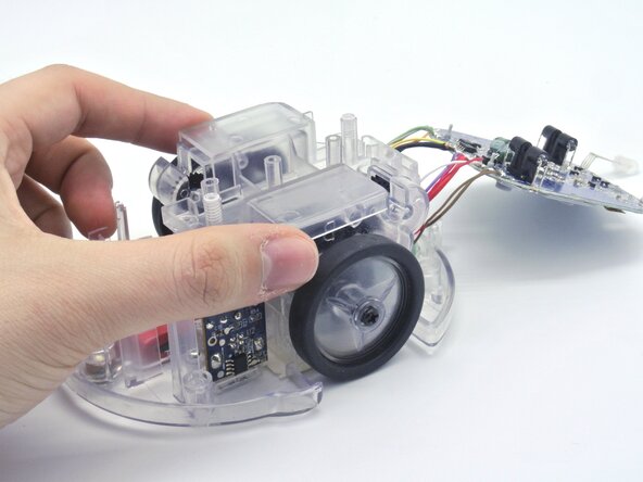

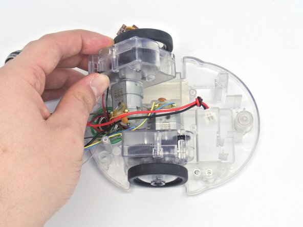

    9. Disassembling the Blue-Bot, Removing the motors: crwdns2935265:09crwdnd2935265:01crwdnd2935265:02crwdne2935265:0 Disassembling the Blue-Bot, Removing the motors: crwdns2935265:09crwdnd2935265:02crwdnd2935265:02crwdne2935265:0
      • Now that everything is out of the way, you can just lift the motors up as shown.

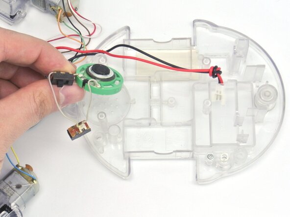

    11. Disassembling the Blue-Bot, Removing the Switches and Speaker: crwdns2935265:011crwdnd2935265:01crwdnd2935265:02crwdne2935265:0 Disassembling the Blue-Bot, Removing the Switches and Speaker: crwdns2935265:011crwdnd2935265:02crwdnd2935265:02crwdne2935265:0
      • You can now remove the switches and the speaker from the chassis.

      • Note: The only way to remove the battery connector is to remove solder on the PCB attaching the cable and pass the able through the hole.
