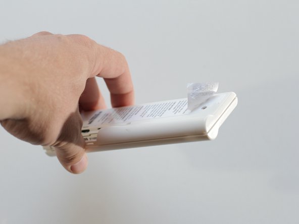

    3. Disassembling iClicker Device: crwdns2935265:03crwdnd2935265:01crwdnd2935265:02crwdne2935265:0 Disassembling iClicker Device: crwdns2935265:03crwdnd2935265:02crwdnd2935265:02crwdne2935265:0
      • Remove the two visible screws using a #00 Phillips screwdriver.
      • Oops! Don't forget a hidden third screw beneath the factory label.
      • Peel back the corner of the label to reveal the hidden screw.
      • If you wish to maintain the integrity of the label, a blowdryer may be used to soften the adhesive on the label before removal.

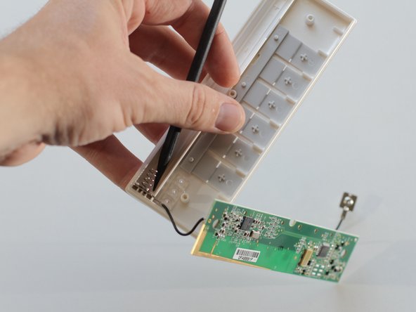

    6. Disassembling iClicker Device: crwdns2935265:06crwdnd2935265:01crwdnd2935265:02crwdne2935265:0 Disassembling iClicker Device: crwdns2935265:06crwdnd2935265:02crwdnd2935265:02crwdne2935265:0
      • Using a spudger, gently pry the battery connectors from the front panel.
    7. Disassembling iClicker Device: crwdns2935265:07crwdnd2935265:01crwdnd2935265:01crwdne2935265:0
      • If your circuit board is stuck in the front panel, use a spudger to lift the circuit board from the front panel.
