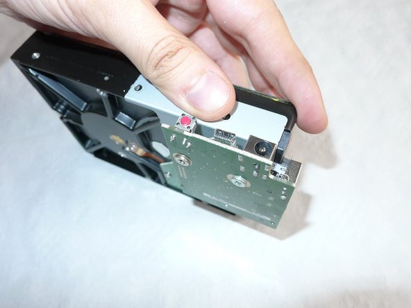

  7. Disassembling Western Digital Essentials HD SATA/USB Bridge Motherboard: crwdns2935265:07crwdnd2935265:01crwdnd2935265:01crwdne2935265:0
    • Remove the rubber piece from the SATA/USB bridge logic board.
  8. Disassembling Western Digital Essentials HD SATA/USB Bridge Motherboard, SATA/USB Bridge Motherboard: crwdns2935265:08crwdnd2935265:01crwdnd2935265:02crwdne2935265:0 Disassembling Western Digital Essentials HD SATA/USB Bridge Motherboard, SATA/USB Bridge Motherboard: crwdns2935265:08crwdnd2935265:02crwdnd2935265:02crwdne2935265:0
    • Remove both screws holding the retaining plate and the hard drive.
    • Slide the retaining plate in order to disconnect the SATA connector.
  9. Disassembling Western Digital Essentials HD SATA/USB Bridge Motherboard: crwdns2935265:09crwdnd2935265:01crwdnd2935265:01crwdne2935265:0
    • Remove both screws holding the retaining plate with the logic board.
