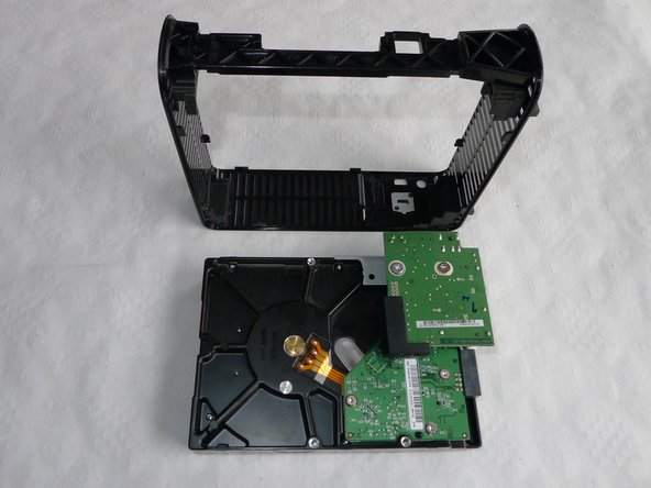

    • Use a large plastic opening tool along the rear panel:
    • There are 4 clips to release.
  2. Disassembling Western Digital Essentials HD Anti-vibration rubber pieces: crwdns2935265:02crwdnd2935265:01crwdnd2935265:02crwdne2935265:0 Disassembling Western Digital Essentials HD Anti-vibration rubber pieces: crwdns2935265:02crwdnd2935265:02crwdnd2935265:02crwdne2935265:0
    • Slide the cover along the plastic frame.
  3. Disassembling Western Digital Essentials HD Anti-vibration rubber pieces, LED Light conducting plastic pieces: crwdns2935265:03crwdnd2935265:01crwdnd2935265:01crwdne2935265:0
    • Slide off the largest plastic pieces.
  4. Disassembling Western Digital Essentials HD Anti-vibration rubber pieces: crwdns2935265:04crwdnd2935265:01crwdnd2935265:03crwdne2935265:0 Disassembling Western Digital Essentials HD Anti-vibration rubber pieces: crwdns2935265:04crwdnd2935265:02crwdnd2935265:03crwdne2935265:0 Disassembling Western Digital Essentials HD Anti-vibration rubber pieces: crwdns2935265:04crwdnd2935265:03crwdnd2935265:03crwdne2935265:0
    • Bend the second small plastic piece to release it from the rubber piece.
    • Now you can slide it out.
  5. Disassembling Western Digital Essentials HD Anti-vibration rubber pieces, Disassembling Western Digital Essentials HD Hard Drive: crwdns2935265:05crwdnd2935265:01crwdnd2935265:02crwdne2935265:0 Disassembling Western Digital Essentials HD Anti-vibration rubber pieces, Disassembling Western Digital Essentials HD Hard Drive: crwdns2935265:05crwdnd2935265:02crwdnd2935265:02crwdne2935265:0
    • Slide out the hard drive as shown in the picture
    • Make sure to slide as shown or you may damage the USB bridge logic board.
  6. Disassembling Western Digital Essentials HD Anti-vibration rubber pieces, Disassembling Western Digital Essentials HD Anti-vibration rubber pieces: crwdns2935265:06crwdnd2935265:01crwdnd2935265:02crwdne2935265:0 Disassembling Western Digital Essentials HD Anti-vibration rubber pieces, Disassembling Western Digital Essentials HD Anti-vibration rubber pieces: crwdns2935265:06crwdnd2935265:02crwdnd2935265:02crwdne2935265:0
    • Remove the 4 rubber piece from the plastic frame at each corner.
  7. Disassembling Western Digital Essentials HD Anti-vibration rubber pieces: crwdns2935265:07crwdnd2935265:01crwdnd2935265:01crwdne2935265:0
    • Remove the rubber piece from the SATA/USB bridge logic board.
