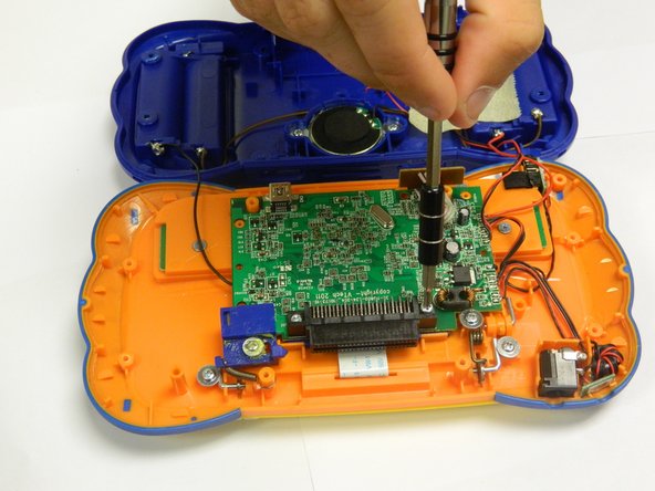

      • Remove the six 6.5 mm Philips J0 screws that are connected to the circuit board.
      • Use light pressure to prevent damage to the circuit board.

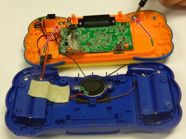

      • Remove the two 4.0 mm Philips J0 screws located on the orange case.
      • Use gentle force to prevent stripping of screws.

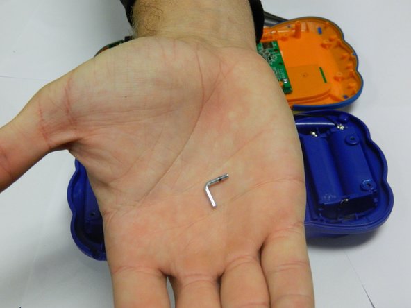

      • Remove the two "L" shaped brackets located on both sides of the device.
      • Use the magnetic mat to store these brackets.

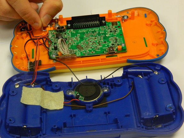

      • Locate the spring that was connected to the "L" shaped bracket and slowly remove it.
    6. Disassembling VTech MobiGo Touch Learning System Keyboard: crwdns2935265:09crwdnd2935265:01crwdnd2935265:02crwdne2935265:0 Disassembling VTech MobiGo Touch Learning System Keyboard: crwdns2935265:09crwdnd2935265:02crwdnd2935265:02crwdne2935265:0

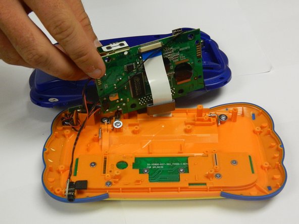

      • Gently lift the circuit board from the case using a plastic opening tool.
      • Make sure to use a plastic opening tool for this step.
