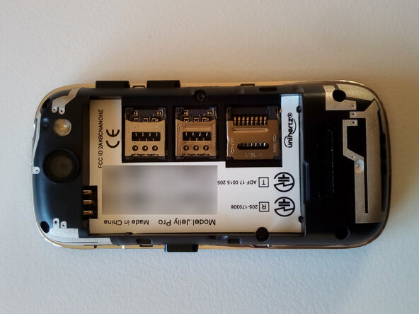

  1. Disassembling Unihertz Jelly (Pro) Mainboard | UART Access, Start with back cover and battery removed: crwdns2935265:01crwdnd2935265:01crwdnd2935265:01crwdne2935265:0

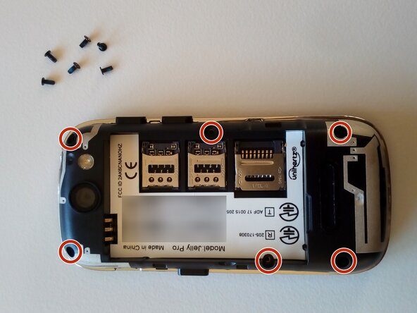

  2. Disassembling Unihertz Jelly (Pro) Mainboard | UART Access, Remove screws: crwdns2935265:02crwdnd2935265:01crwdnd2935265:01crwdne2935265:0
    • Remove the six Phillips-head screws in the back casing. One screw in the battery compartment might be hidden under a white sticker!
