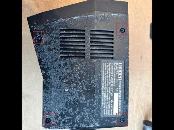

Locate the four Phillips screws on the bottom shell.
Using a Phillips #0, remove all four screws.
Sort and label the screws so you can return them to their original locations.

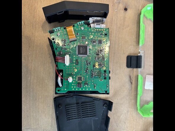

Starting at a rear corner, gently lift the top cover.
As the cover rises, watch the USB-Micro opening: the plastic lip can catch on the port.
If it binds, insert a plastic pick between the shell and the port cutout to relieve pressure.
Optional—access to speaker and adjacent parts:
Carefully lift the main board just enough to reach the speaker (and nearby connectors/components).
Handle the board by the edges only. Do not yank, watch for any wires or short ribbon leads attached underneath.
If a connector resists, use a spudger to gently work it free; avoid prying on components.
