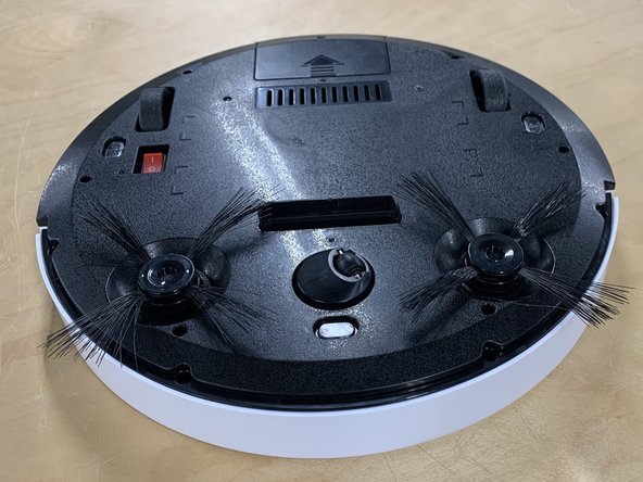

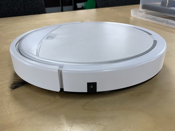

    • You will need a PH0 screwdriver.
    • First make sure the power is turned off. (this is the red switch on the bottom.)
    • This then can be followed by removing the side brush.

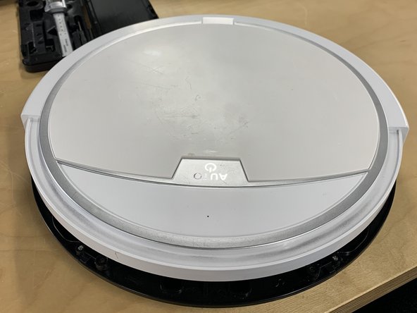

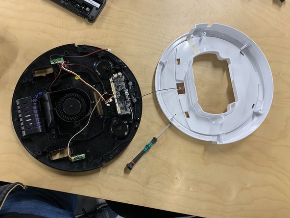

    • Next remove the screws connecting the top of the bumper to the bottom.
    • Then remove the top of the bumper. By lifting and pulling the plate towards yourself.
  3. Disassembling Unbranded Robot Vacuum (full disassembly): crwdns2935265:03crwdnd2935265:01crwdnd2935265:03crwdne2935265:0 Disassembling Unbranded Robot Vacuum (full disassembly): crwdns2935265:03crwdnd2935265:02crwdnd2935265:03crwdne2935265:0 Disassembling Unbranded Robot Vacuum (full disassembly): crwdns2935265:03crwdnd2935265:03crwdnd2935265:03crwdne2935265:0

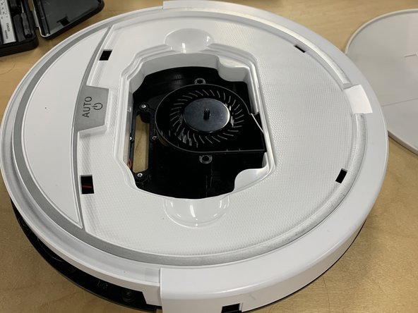

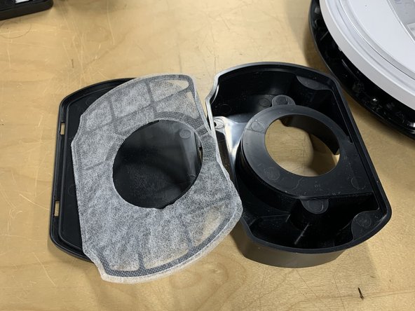

    • Remove the top white plate.
    • Remove the fan housing part.
    • Remove the filter from the part by popping the lid off the part. (this can be done with your hands.)
  4. Disassembling Unbranded Robot Vacuum (full disassembly): crwdns2935265:04crwdnd2935265:01crwdnd2935265:02crwdne2935265:0 Disassembling Unbranded Robot Vacuum (full disassembly): crwdns2935265:04crwdnd2935265:02crwdnd2935265:02crwdne2935265:0

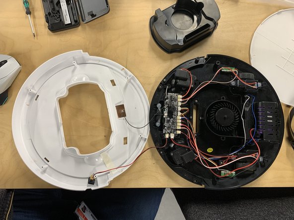

    • After Unscrew the rest of the plates from the base.
    • Next remove the base from the top as shown. (make sure to be careful as the lid and the base are attached by a wire.
  5. Disassembling Unbranded Robot Vacuum (full disassembly): crwdns2935265:05crwdnd2935265:01crwdnd2935265:03crwdne2935265:0 Disassembling Unbranded Robot Vacuum (full disassembly): crwdns2935265:05crwdnd2935265:02crwdnd2935265:03crwdne2935265:0 Disassembling Unbranded Robot Vacuum (full disassembly): crwdns2935265:05crwdnd2935265:03crwdnd2935265:03crwdne2935265:0

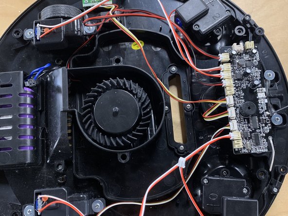

    • Now unplug the battery.
    • After unplug all the components MAKING SURE TO KEEP TRACK OF WHAT GOES WHERE!

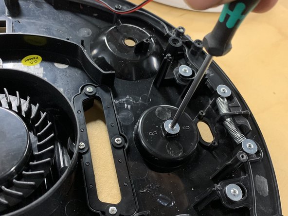

    • Once done unscrew the motors and remove them from the chasis.

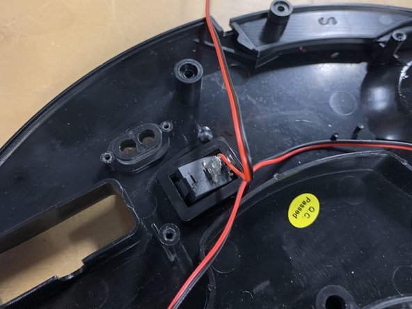

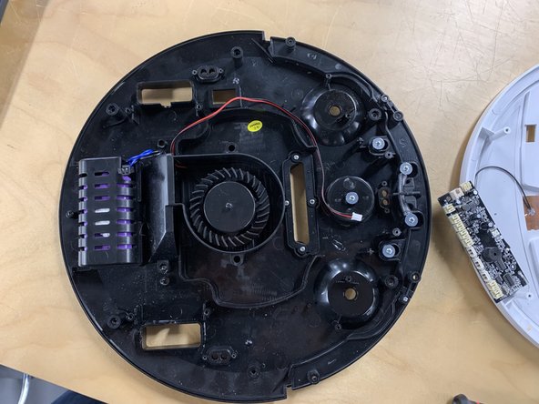

  6. Disassembling Unbranded Robot Vacuum (full disassembly): crwdns2935265:06crwdnd2935265:01crwdnd2935265:03crwdne2935265:0 Disassembling Unbranded Robot Vacuum (full disassembly): crwdns2935265:06crwdnd2935265:02crwdnd2935265:03crwdne2935265:0 Disassembling Unbranded Robot Vacuum (full disassembly): crwdns2935265:06crwdnd2935265:03crwdnd2935265:03crwdne2935265:0
    • Now the motherboard must be removed. Unscrew the motherboard and remove so that other components can be removed.
    • Once removed all of the IR sensors can be removed.
    • Unscrew and remove the IR sensors followed by popping out the power switch (this will require some force.)

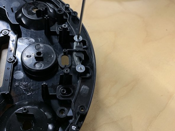

    • Next unscrew the universal directional wheel.
    • Next unscrew the lower bumper and remove it.

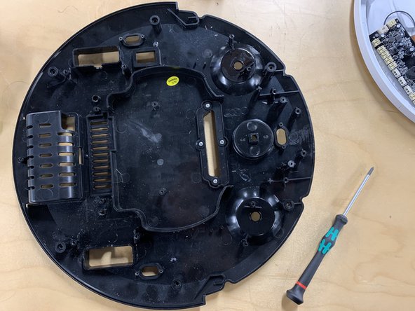

    • Now unscrew the lower fan housing and remove.

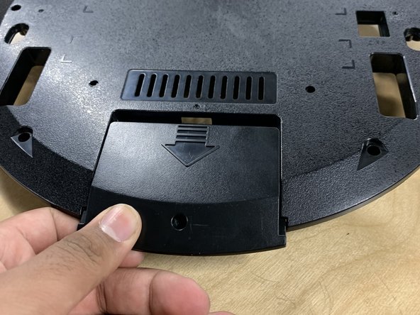

    • Flip over the product and unscrew the back panel. Then remove the battery.

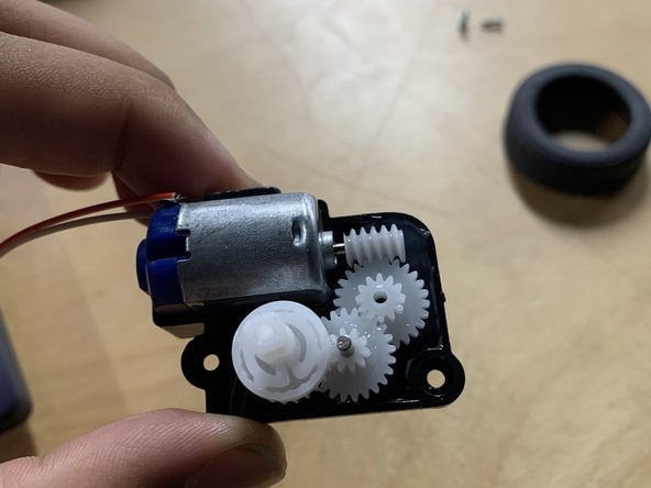

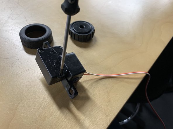

    • Sub assembly of Motor and Wheel.
    • First unscrew the wheel from the motor.
    • Next remove the tyre from the wheel.
    • After unscrew the motor and open it.

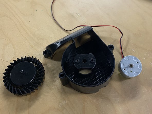

    • Disassembly of fan and holder.
    • First remove the fan. (This will require some force.)
    • Next unscrew the motor and remove.

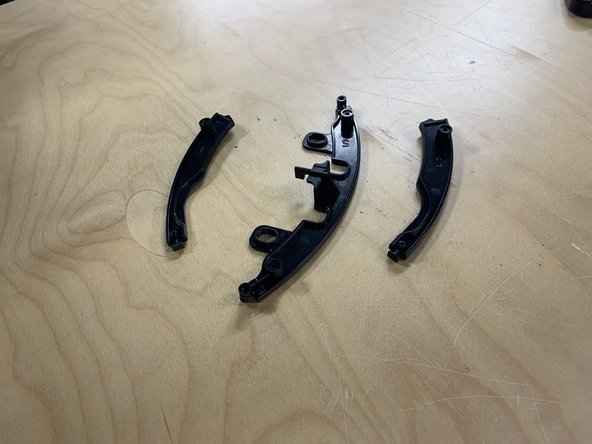

    • Disassembly of lower bumper.
    • Unscrew the plates and remove.
