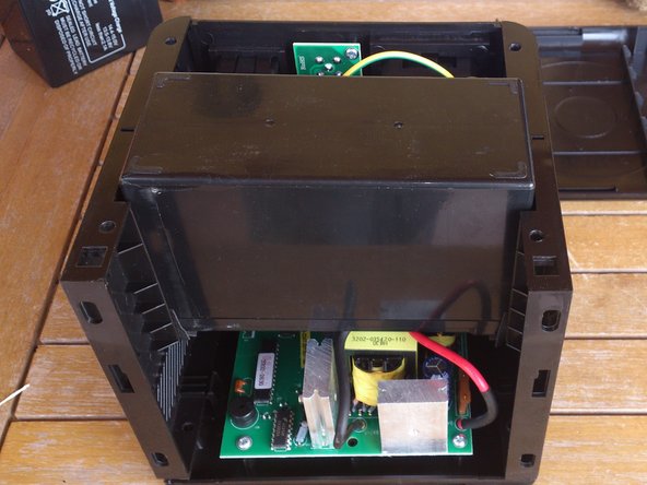

    • Before you begin, be sure to shut off the UPS and unplug it. You do not want the UPS to kick in while you're performing the procedure.
    • Remove the screws (2) under the device
  2. Disassembling UPS OVISLINK TRACITE CUBE or CUBO All, Open the front pannel: crwdns2935265:02crwdnd2935265:01crwdnd2935265:03crwdne2935265:0 Disassembling UPS OVISLINK TRACITE CUBE or CUBO All, Open the front pannel: crwdns2935265:02crwdnd2935265:02crwdnd2935265:03crwdne2935265:0 Disassembling UPS OVISLINK TRACITE CUBE or CUBO All, Open the front pannel: crwdns2935265:02crwdnd2935265:03crwdnd2935265:03crwdne2935265:0
    • Slide the front pannel up
  3. Disassembling UPS OVISLINK TRACITE CUBE or CUBO All, Remove the Bottom pannel: crwdns2935265:03crwdnd2935265:01crwdnd2935265:03crwdne2935265:0 Disassembling UPS OVISLINK TRACITE CUBE or CUBO All, Remove the Bottom pannel: crwdns2935265:03crwdnd2935265:02crwdnd2935265:03crwdne2935265:0 Disassembling UPS OVISLINK TRACITE CUBE or CUBO All, Remove the Bottom pannel: crwdns2935265:03crwdnd2935265:03crwdnd2935265:03crwdne2935265:0
    • Remove left/right clips. And remove the bottom pannel

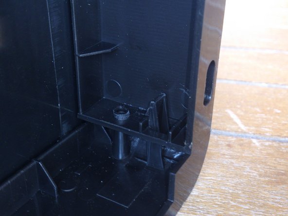

  4. Disassembling UPS OVISLINK TRACITE CUBE or CUBO All, Remove the Battery: crwdns2935265:04crwdnd2935265:01crwdnd2935265:01crwdne2935265:0
    • Be careful

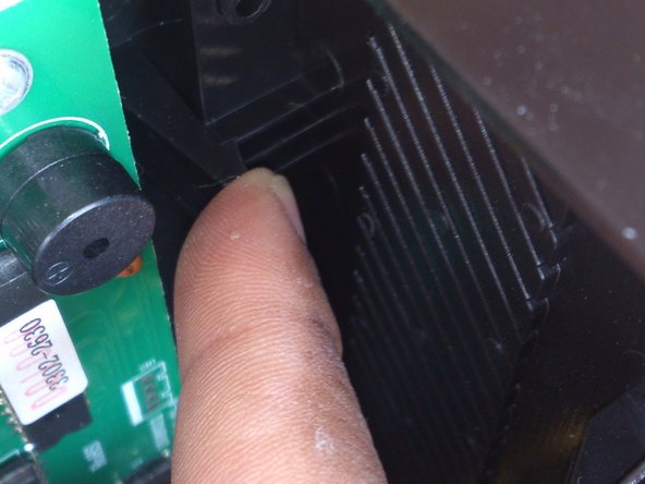

  5. Disassembling UPS OVISLINK TRACITE CUBE or CUBO All, Remove the left side: crwdns2935265:05crwdnd2935265:01crwdnd2935265:03crwdne2935265:0 Disassembling UPS OVISLINK TRACITE CUBE or CUBO All, Remove the left side: crwdns2935265:05crwdnd2935265:02crwdnd2935265:03crwdne2935265:0 Disassembling UPS OVISLINK TRACITE CUBE or CUBO All, Remove the left side: crwdns2935265:05crwdnd2935265:03crwdnd2935265:03crwdne2935265:0
    • Unclip the left pannel

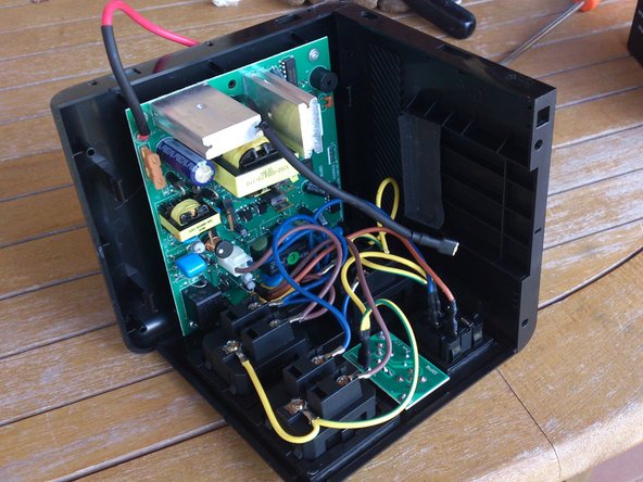

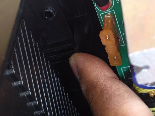

  6. Disassembling UPS OVISLINK TRACITE CUBE or CUBO All, Remove the right side: crwdns2935265:06crwdnd2935265:01crwdnd2935265:03crwdne2935265:0 Disassembling UPS OVISLINK TRACITE CUBE or CUBO All, Remove the right side: crwdns2935265:06crwdnd2935265:02crwdnd2935265:03crwdne2935265:0 Disassembling UPS OVISLINK TRACITE CUBE or CUBO All, Remove the right side: crwdns2935265:06crwdnd2935265:03crwdnd2935265:03crwdne2935265:0
    • Unclip the right pannel

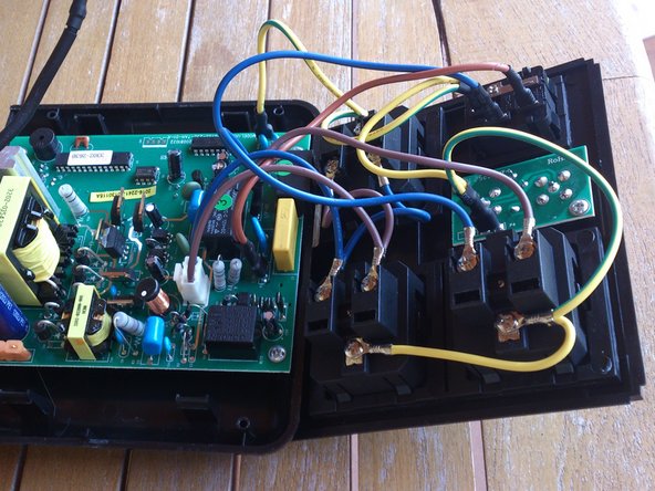

  7. Disassembling UPS OVISLINK TRACITE CUBE or CUBO All, Remove the rear pannel: crwdns2935265:07crwdnd2935265:01crwdnd2935265:01crwdne2935265:0
    • Caution when pluging the rear pannel...
    • -blue for neutral.
    • -yelow/green for earth
    • -brown for phase
