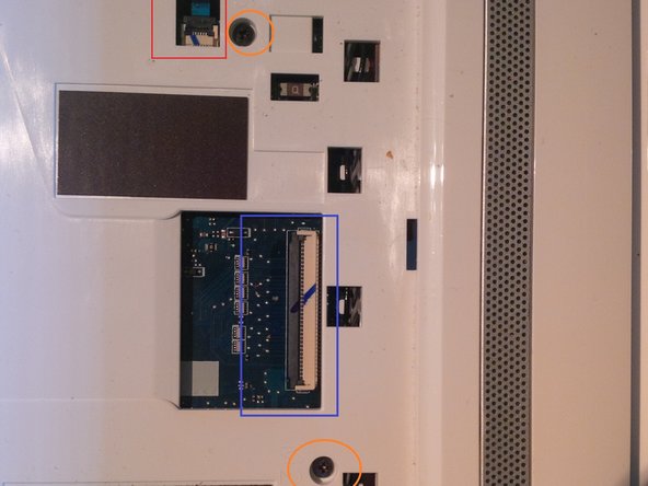

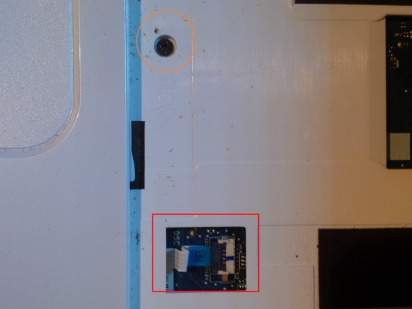

  5. Disassembling Toshiba Satellite C55-A5285/C55-A1J2, removing screws and connectors: crwdns2935265:05crwdnd2935265:01crwdnd2935265:03crwdne2935265:0 Disassembling Toshiba Satellite C55-A5285/C55-A1J2, removing screws and connectors: crwdns2935265:05crwdnd2935265:02crwdnd2935265:03crwdne2935265:0 Disassembling Toshiba Satellite C55-A5285/C55-A1J2, removing screws and connectors: crwdns2935265:05crwdnd2935265:03crwdnd2935265:03crwdne2935265:0
    • now you will see 2 connectors and 7 screws under the keyboard.
    • If you don't know how to remove the connectors safely see the next step.
    • remove the screws and gently remove the 2 connectors from the connectors. like always do it gently.
    • the orange circkles are the screws to remove the mainboard in a later step
    • the red squares are the connectors of the mouse pad and powerboard
    • the blue square is the connector from the keyboard.

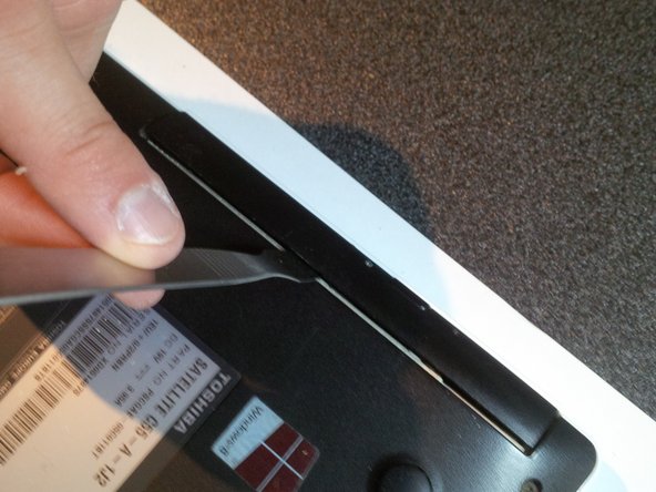

  6. Disassembling Toshiba Satellite C55-A5285/C55-A1J2, removing connectors: crwdns2935265:06crwdnd2935265:01crwdnd2935265:02crwdne2935265:0 Disassembling Toshiba Satellite C55-A5285/C55-A1J2, removing connectors: crwdns2935265:06crwdnd2935265:02crwdnd2935265:02crwdne2935265:0
    • use a spudger or little flathead screwdriver to open the lid of the connectors.

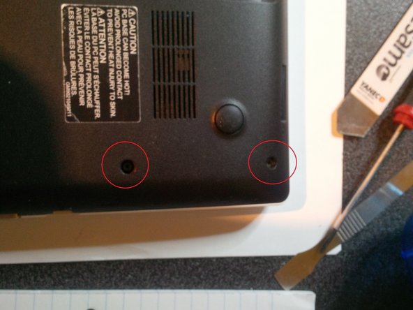

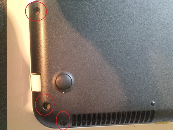

  7. Disassembling Toshiba Satellite C55-A5285/C55-A1J2, removing screws of case: crwdns2935265:07crwdnd2935265:01crwdnd2935265:03crwdne2935265:0 Disassembling Toshiba Satellite C55-A5285/C55-A1J2, removing screws of case: crwdns2935265:07crwdnd2935265:02crwdnd2935265:03crwdne2935265:0 Disassembling Toshiba Satellite C55-A5285/C55-A1J2, removing screws of case: crwdns2935265:07crwdnd2935265:03crwdnd2935265:03crwdne2935265:0
    • again : draw a map of the laptop , so you remeber where all the screws come from. Or use a magnetic project map.
    • first screws : 3 screws in the HDD compartiment.
    • screws at the side , also see the next step for the rest of the screws.

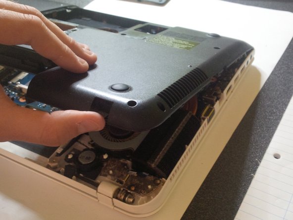

  9. Disassembling Toshiba Satellite C55-A5285/C55-A1J2, opening the laptop: crwdns2935265:09crwdnd2935265:01crwdnd2935265:03crwdne2935265:0 Disassembling Toshiba Satellite C55-A5285/C55-A1J2, opening the laptop: crwdns2935265:09crwdnd2935265:02crwdnd2935265:03crwdne2935265:0 Disassembling Toshiba Satellite C55-A5285/C55-A1J2, opening the laptop: crwdns2935265:09crwdnd2935265:03crwdnd2935265:03crwdne2935265:0
    • gently remove the plate.
    • after opening you'll see the mainboard or like we call it here in Belgium : the motherboard.
