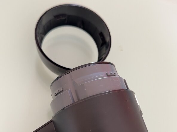

  1. Disassembling Tineco Floor One Switch S6 SwitchPro Motor, Take cover off: crwdns2935265:01crwdnd2935265:01crwdnd2935265:02crwdne2935265:0 Disassembling Tineco Floor One Switch S6 SwitchPro Motor, Take cover off: crwdns2935265:01crwdnd2935265:02crwdnd2935265:02crwdne2935265:0
    • Turn the plastic around the screen counterclockwise then lift up, it should come off pretty gently

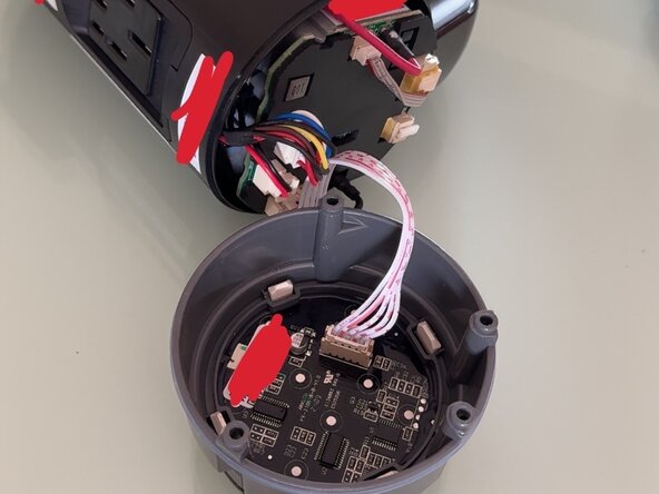

  2. Disassembling Tineco Floor One Switch S6 SwitchPro Motor, Unscrew and pull up screen: crwdns2935265:02crwdnd2935265:01crwdnd2935265:02crwdne2935265:0 Disassembling Tineco Floor One Switch S6 SwitchPro Motor, Unscrew and pull up screen: crwdns2935265:02crwdnd2935265:02crwdnd2935265:02crwdne2935265:0
    • Unscrew the 4 screws on the side then pull the screen up. You have to wiggle it around a little bit but it should still go up pretty easily

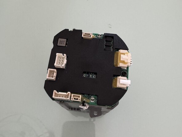

  3. Disassembling Tineco Floor One Switch S6 SwitchPro Motor, Disconnect and pull out battery: crwdns2935265:03crwdnd2935265:01crwdnd2935265:02crwdne2935265:0 Disassembling Tineco Floor One Switch S6 SwitchPro Motor, Disconnect and pull out battery: crwdns2935265:03crwdnd2935265:02crwdnd2935265:02crwdne2935265:0
    • Disconnect all the cables apart from the 2 marked ones then pull battery out

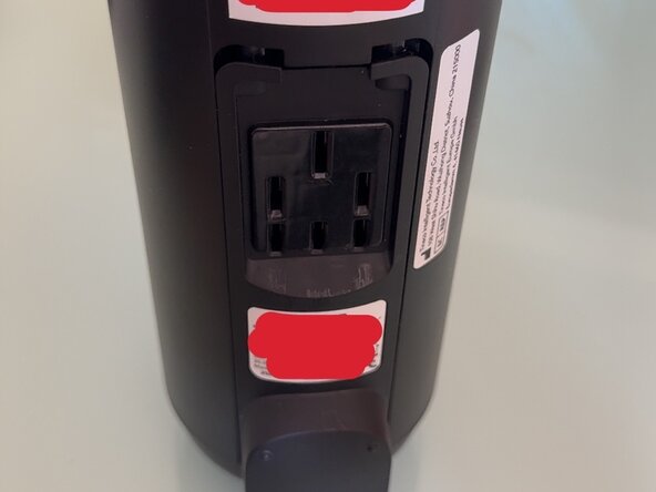

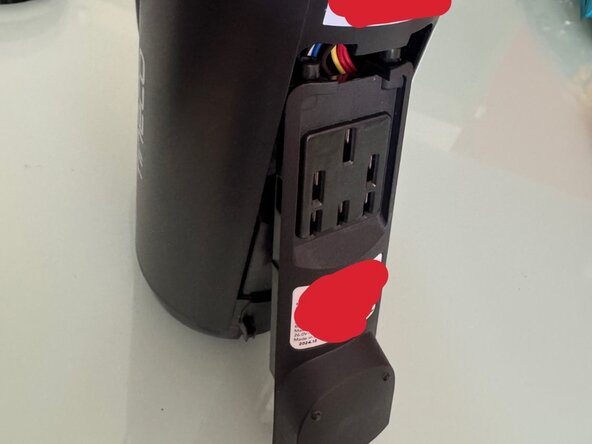

  4. Disassembling Tineco Floor One Switch S6 SwitchPro Motor, Remove charging panel: crwdns2935265:04crwdnd2935265:01crwdnd2935265:03crwdne2935265:0 Disassembling Tineco Floor One Switch S6 SwitchPro Motor, Remove charging panel: crwdns2935265:04crwdnd2935265:02crwdnd2935265:03crwdne2935265:0 Disassembling Tineco Floor One Switch S6 SwitchPro Motor, Remove charging panel: crwdns2935265:04crwdnd2935265:03crwdnd2935265:03crwdne2935265:0
    • Simply pull the panel down then lift the bottom and it should come out.

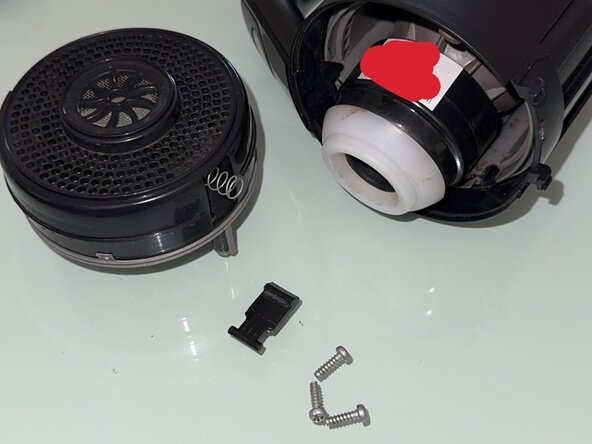

  5. Disassembling Tineco Floor One Switch S6 SwitchPro Motor, Access suction motor: crwdns2935265:05crwdnd2935265:01crwdnd2935265:02crwdne2935265:0 Disassembling Tineco Floor One Switch S6 SwitchPro Motor, Access suction motor: crwdns2935265:05crwdnd2935265:02crwdnd2935265:02crwdne2935265:0
    • Now to access the bottom part where the suction motor is you need to unscrew these 3.
    • Once you are done unscrewing you can take the bottom plastic off by pulling it out. Be careful as the small plastic piece is not held by anything and is in front of a spring so if you dont hold it when pulling the bottom plastic it will shoot out.
