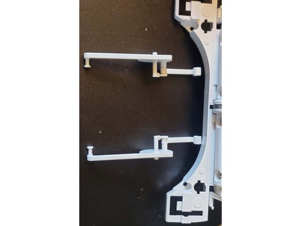

    • Remove the two pins on either side of the motor cartridge that hold the arms in place. They should come out with a shake, but you can also use tweezers to grab them if they're not coming out. Keep the pins safe.
    • Swing the arms out, and remove them by lining up the notch shown in the third image. These arms are two pieces clipped together - they can also be pulled apart.
    • The arms can easily be replaced with 3d printed parts.

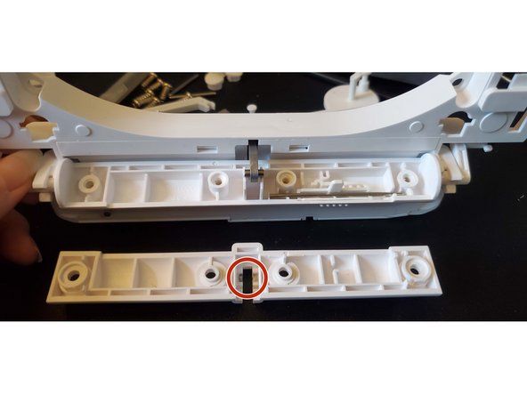

  3. Disassembling Surepet Surefeed Microchip Pet Feeder Motor cartridge, Free the motor and daughter circuit: crwdns2935265:04crwdnd2935265:01crwdnd2935265:02crwdne2935265:0 Disassembling Surepet Surefeed Microchip Pet Feeder Motor cartridge, Free the motor and daughter circuit: crwdns2935265:04crwdnd2935265:02crwdnd2935265:02crwdne2935265:0
    • This is the tricky part: the rest of the motor cartridge is two pieces held together by 5 snap tabs. Use your pry tools to push these tabs in, and stick a pry tool between the two halves to work your way around the clips. I started with the top clip (as seen in the first photo), then the left and right, then the bottom ones.
    • Use the second image as a reference to see where the seam is between the two halves.

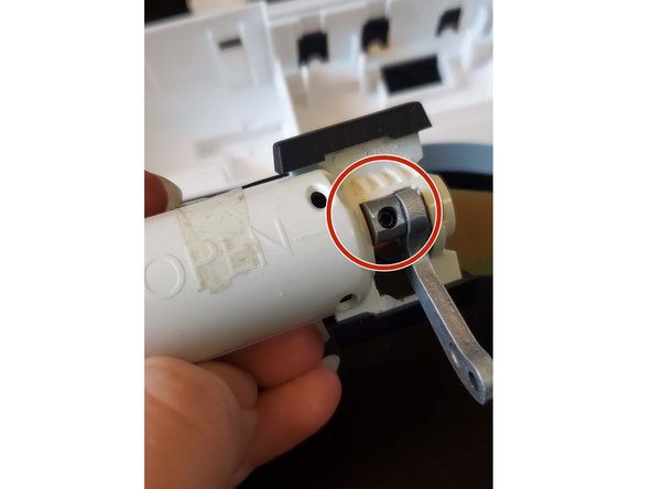

  4. Disassembling Surepet Surefeed Microchip Pet Feeder Motor cartridge, Tighten the set screw on the motor: crwdns2935265:05crwdnd2935265:01crwdnd2935265:03crwdne2935265:0 Disassembling Surepet Surefeed Microchip Pet Feeder Motor cartridge, Tighten the set screw on the motor: crwdns2935265:05crwdnd2935265:02crwdnd2935265:03crwdne2935265:0 Disassembling Surepet Surefeed Microchip Pet Feeder Motor cartridge, Tighten the set screw on the motor: crwdns2935265:05crwdnd2935265:03crwdnd2935265:03crwdne2935265:0
    • The motor and daughter circuit board should pull right out. Find the set screw holding the lid mechanism linkage to the motor (second photo). If your motor wasn't opening the lid or making a clicking sound, this has probably come loose.

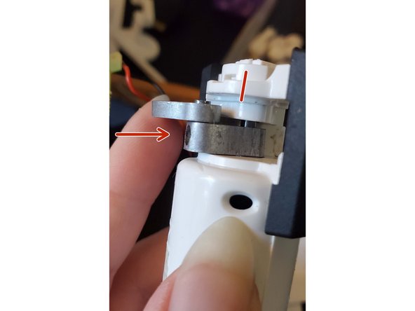

    • The shaft of the motor is a D shape, and the set screw needs to be tightened on the flat side - the line in the third photo. is parallel to the desired flat side, and the arrow shows the direction the set screw should be.
    • At this point, you may need to power the motor and allow the motor to rotate so the flat side can be lined up with the set screw. On the main unit, screw the battery housing back on (undo the step at 1:11 on Surepet's video), insert batteries, and connect the ribbon cable, paying attention to the direction of the connector clip.
    • Press the open/close button on the daughter circuit board so the motor attempts to move the lid. Then pull one of the batteries out when the shaft is aligned as seen in the third image.
    • Be very careful not to touch any circuit boards with metal tools or dirty hands, or to cross any wires when you do this (it's ok to interact with the smaller circuit board to press the open/close button). Once you've gotten the shaft aligned, the set screw tightened, and tested that the motor works as intended, take the batteries out.
    • An interesting point here: there is no limit switch telling the motor when to stop. When these metal pieces come into contact with its housing, the motor can't spin anymore and will draw more current to attempt to keep going. Only then does the circuit stop powering the motor.
    • If the lid does work correctly on your unit but makes a ticking sound, this may be because the set screw is just a little loose, so the motor isn't able to find a definitive stopping point. It then doesn't draw enough current for the circuit to stop powering it fully. The motor's attempt to keep going can also further loosen the set screw.
    • This is not the most robust design, as this is what causes the set screw to loosen. You'll have to keep re-tightening it over time, and in extreme cases, this may lead to the motor housing cracking, or gears inside the motor breaking.
