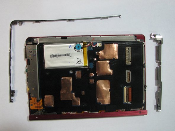

  6. Disassembling Sony Reader Touch Edition PRS-600 Side and Bottom Panel, Side and Bottom Panel: crwdns2935265:06crwdnd2935265:01crwdnd2935265:02crwdne2935265:0 Disassembling Sony Reader Touch Edition PRS-600 Side and Bottom Panel, Side and Bottom Panel: crwdns2935265:06crwdnd2935265:02crwdnd2935265:02crwdne2935265:0
    • Using a Phillips head screwdriver, remove the two 1.4 mm screws from the bottom panel of the device.
    • Using the same screwdriver, remove the 1.4 mm screw that is located on the back of the device.
  7. Disassembling Sony Reader Touch Edition PRS-600 Side and Bottom Panel: crwdns2935265:07crwdnd2935265:01crwdnd2935265:02crwdne2935265:0 Disassembling Sony Reader Touch Edition PRS-600 Side and Bottom Panel: crwdns2935265:07crwdnd2935265:02crwdnd2935265:02crwdne2935265:0
    • Pull the panel away from the device. You may have to use the flat end of the spudger to remove the side portion of the panel because it will be glued in place.
