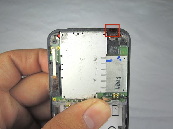

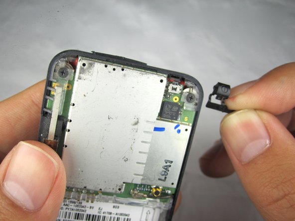

  4. Disassembling Sony Ericsson W580i Back Cover: crwdns2935265:04crwdnd2935265:01crwdnd2935265:03crwdne2935265:0 Disassembling Sony Ericsson W580i Back Cover: crwdns2935265:04crwdnd2935265:02crwdnd2935265:03crwdne2935265:0 Disassembling Sony Ericsson W580i Back Cover: crwdns2935265:04crwdnd2935265:03crwdnd2935265:03crwdne2935265:0
    • While removing the back cover do not lose the power button. It is held in place by the back cover and may fall off during removal.
    • Pull the back cover away from the phone.
    • Remove the power button if it has not already come off.
