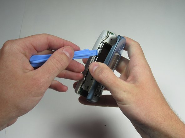

  2. Disassembling Sony Ericsson T68i: crwdns2935265:02crwdnd2935265:01crwdnd2935265:03crwdne2935265:0 Disassembling Sony Ericsson T68i: crwdns2935265:02crwdnd2935265:02crwdnd2935265:03crwdne2935265:0 Disassembling Sony Ericsson T68i: crwdns2935265:02crwdnd2935265:03crwdnd2935265:03crwdne2935265:0

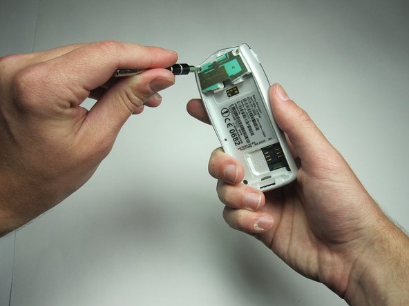

    • Remove the plastic cover from the back. Pry it off from the top first with a thin plastic shim, then remove it from the two bottom clips.
    • When removing the top part do not bend it too far down, or else you risk breaking the two bottom clips.

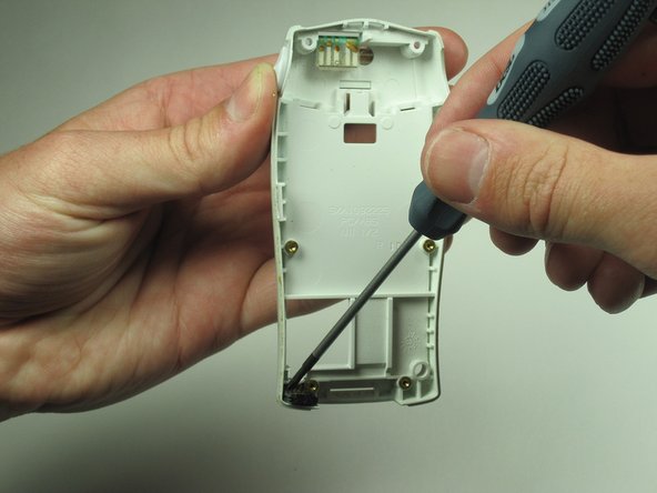

  3. Disassembling Sony Ericsson T68i: crwdns2935265:03crwdnd2935265:01crwdnd2935265:03crwdne2935265:0 Disassembling Sony Ericsson T68i: crwdns2935265:03crwdnd2935265:02crwdnd2935265:03crwdne2935265:0 Disassembling Sony Ericsson T68i: crwdns2935265:03crwdnd2935265:03crwdnd2935265:03crwdne2935265:0
    • Unscrew all four Torx T6 screws.
    • Keep in a safe place.

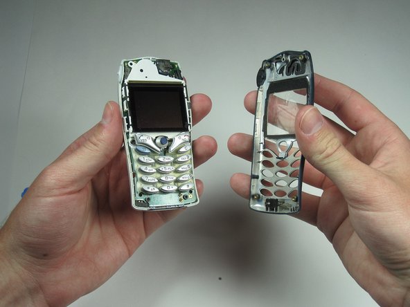

  4. Disassembling Sony Ericsson T68i: crwdns2935265:04crwdnd2935265:01crwdnd2935265:03crwdne2935265:0 Disassembling Sony Ericsson T68i: crwdns2935265:04crwdnd2935265:02crwdnd2935265:03crwdne2935265:0 Disassembling Sony Ericsson T68i: crwdns2935265:04crwdnd2935265:03crwdnd2935265:03crwdne2935265:0
    • After removing the screws, the two halves will separate. If not, then pry them gently apart.

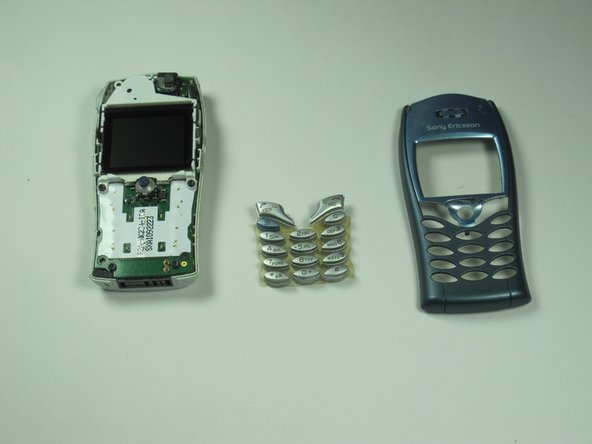

    • Pull off the keypad.

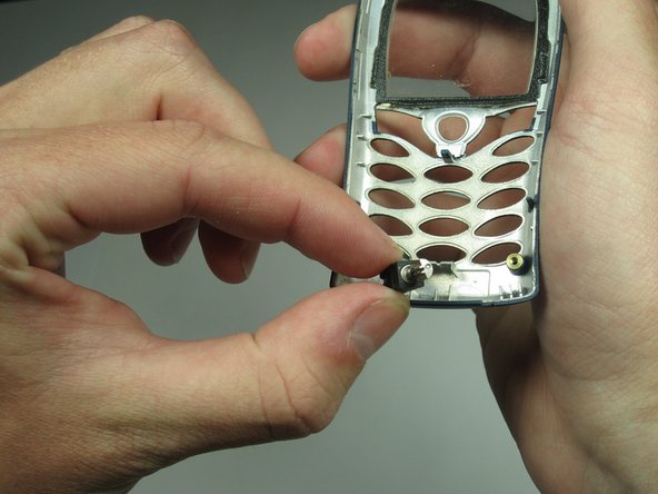

  6. Disassembling Sony Ericsson T68i: crwdns2935265:06crwdnd2935265:01crwdnd2935265:03crwdne2935265:0 Disassembling Sony Ericsson T68i: crwdns2935265:06crwdnd2935265:02crwdnd2935265:03crwdne2935265:0 Disassembling Sony Ericsson T68i: crwdns2935265:06crwdnd2935265:03crwdnd2935265:03crwdne2935265:0
    • Gently pull off the infra red window and the vibra motor.

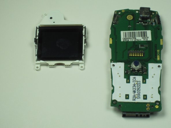

  8. Disassembling Sony Ericsson T68i: crwdns2935265:08crwdnd2935265:01crwdnd2935265:03crwdne2935265:0 Disassembling Sony Ericsson T68i: crwdns2935265:08crwdnd2935265:02crwdnd2935265:03crwdne2935265:0 Disassembling Sony Ericsson T68i: crwdns2935265:08crwdnd2935265:03crwdnd2935265:03crwdne2935265:0
    • Remove the board and screen.

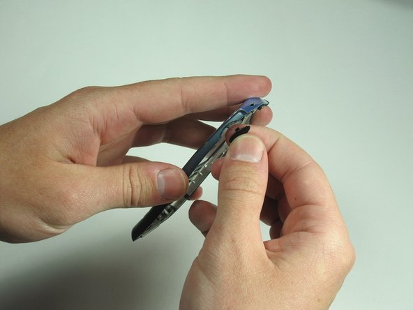

    • Lever out the microphone using a small screwdriver or any similar tool.

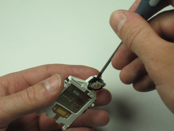

    • Carefully remove the plastic clips holding the screen on the board.
  11. Disassembling Sony Ericsson T68i: crwdns2935265:011crwdnd2935265:01crwdnd2935265:03crwdne2935265:0 Disassembling Sony Ericsson T68i: crwdns2935265:011crwdnd2935265:02crwdnd2935265:03crwdne2935265:0 Disassembling Sony Ericsson T68i: crwdns2935265:011crwdnd2935265:03crwdnd2935265:03crwdne2935265:0

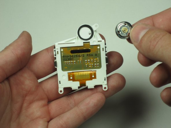

    • Remove the speaker located in the screen housing just above the screen.
    • Gently pry it out with a small screwdriver or similar tool.

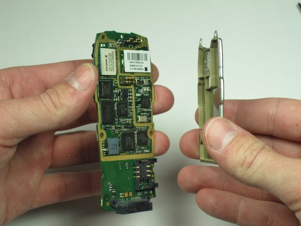

  12. Disassembling Sony Ericsson T68i: crwdns2935265:012crwdnd2935265:01crwdnd2935265:03crwdne2935265:0 Disassembling Sony Ericsson T68i: crwdns2935265:012crwdnd2935265:02crwdnd2935265:03crwdne2935265:0 Disassembling Sony Ericsson T68i: crwdns2935265:012crwdnd2935265:03crwdnd2935265:03crwdne2935265:0

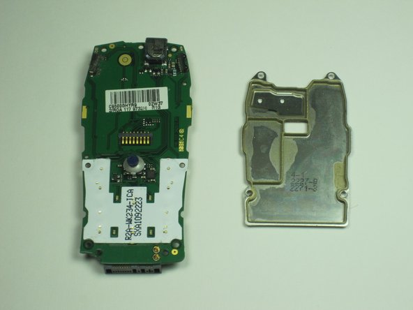

    • Remove the plate from the circuit board protecting the more delicate processing parts.
