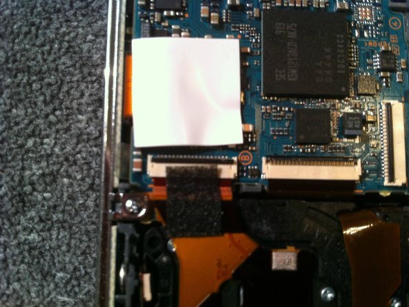

  12. Disassembling Sony Cyber-shot DSC-W230 Removing the Camera Sensor, Disassembling Sony Cyber-shot DSC-W230 Removing the Camera Sensor: crwdns2935265:012crwdnd2935265:01crwdnd2935265:02crwdne2935265:0 Disassembling Sony Cyber-shot DSC-W230 Removing the Camera Sensor, Disassembling Sony Cyber-shot DSC-W230 Removing the Camera Sensor: crwdns2935265:012crwdnd2935265:02crwdnd2935265:02crwdne2935265:0
    • After removal of the LCD screen and ribbon cable the camera sensor can be accessed.
    • Position the camera with the circuit board facing up, showing the two ribbon cables connecting the camera sensor.
    • Gently pry the black tabs on both cables until they are flipped up.
    • Gently pull the ribbon cables until they slide out of the connectors.
