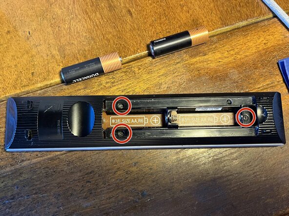

    • Remove battery compartment cover and batteries
    • Remove 3 screws (probably JIS #0 or #00)

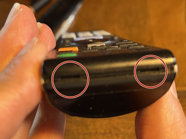

  2. Disassembling Sony Bravia RM-YD023 Remote Control, Carefully Pry End: crwdns2935265:02crwdnd2935265:01crwdnd2935265:01crwdne2935265:0
    • Gently and carefully pry whichever end is most easily separated, using a spudger, single-edge razor blade, or other thin, strong, stiff tool.
    • The unfortunately blurry photo shows that for me, the top/front end (with the IR LED) separated most easily. Red circles indicate rectangular latch points.

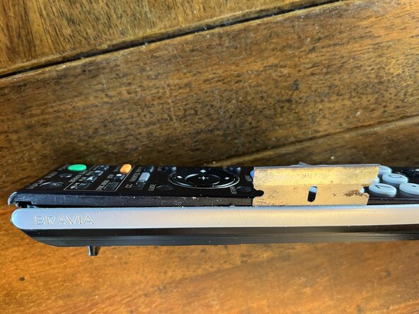

  3. Disassembling Sony Bravia RM-YD023 Remote Control, Unlatch Side: crwdns2935265:03crwdnd2935265:01crwdnd2935265:03crwdne2935265:0 Disassembling Sony Bravia RM-YD023 Remote Control, Unlatch Side: crwdns2935265:03crwdnd2935265:02crwdnd2935265:03crwdne2935265:0 Disassembling Sony Bravia RM-YD023 Remote Control, Unlatch Side: crwdns2935265:03crwdnd2935265:03crwdnd2935265:03crwdne2935265:0
    • With an end loosened, one side is likely to be more readily loosened. For me, it was the left side.
    • Starting at the loosened end, carefully pry the top panel above the silver side insert at the seam of these two pieces along the length of the side.
    • Once the side has been loosened along its entire length, it is highly likely that the opposite end latches will have released. The top panel can be lifted out at this time.
    • Second photo shows left side latch points. Third photo shows right side latch points.

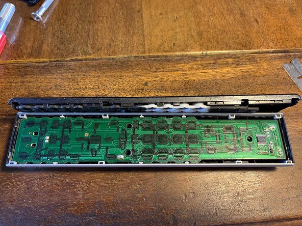

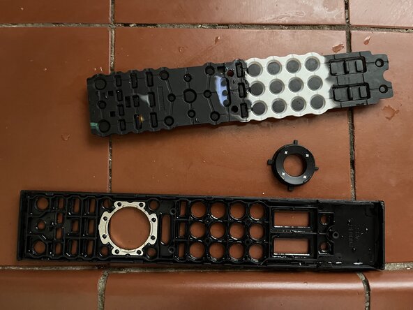

    • Remove the rubbery conductive plastic button matrix from the top cover if necessary. It may have already fallen out via gravity.

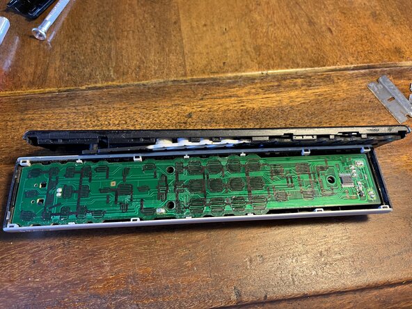

    • Being mindful of how the spring metal battery contacts are held into the lower housing, remove the PCB from the lower housing. With gentle help easing the springs, the PCB lifts straight up and out.
    • No need to remove the silver decorative side panels unless deep cleaning or damage repair is necessary in these areas. They can be removed via lifting straight up (towards the top panel surface when assembled).
    • Carefully inspect the PCB and rubbery conductive plastic button matrix for any signs of damage:
    • Liquid spills/residue (dry, damp, or wet)
    • Fractured solder joints (PCB)
    • Damaged traces (PCB)
    • Tears (rubbery button matrix)
  4. Disassembling Sony Bravia RM-YD023 Remote Control, Repair Any Damage: crwdns2935265:05crwdnd2935265:01crwdnd2935265:03crwdne2935265:0 Disassembling Sony Bravia RM-YD023 Remote Control, Repair Any Damage: crwdns2935265:05crwdnd2935265:02crwdnd2935265:03crwdne2935265:0 Disassembling Sony Bravia RM-YD023 Remote Control, Repair Any Damage: crwdns2935265:05crwdnd2935265:03crwdnd2935265:03crwdne2935265:0

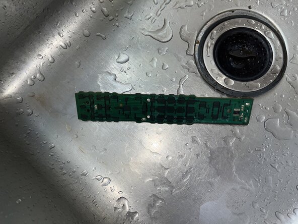

    • There was obvious dried liquid residue on the contact areas of many of the buttons on the rubbery conductive plastic matrix, as well as some mating contact areas on the PCB. Water seemed like the best solvent choice for these apparently food-based contaminants.
    • Rinsed the conductive button matrix then the PCB in ambient temperature tap water with gentle finger rubbing where necessary until all visible contamination was removed.
    • Also rinsed the top panel, lower body, and circular selector arrow ring plastics in tap water.
    • Thoroughly dried all these pieces in the sun.

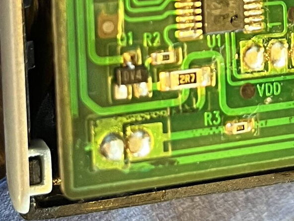

    • Solder joints looked good, but two PCB traces looked iffy (third picture). Resistance tested OK, so left them alone for now. Might be a future point of failure.

    • Historically, rubbery conductive plastic button matrices have tended to lose conductivity—especially on the most-used buttons, which become harder to press. No known issues with that on this particular remote control, but worth testing whilst it is apart.
    • Probe each rubbery plastic button’s contact surface with probes spaced about 1/2 cm apart, or any other consistent value which works for you. Resistance will vary significantly with probe spacing and test pressure. Look for consistency between different buttons rather than a specific resistance value.
    • All buttons on this remote were in the 4kΩ range and the user reported no issues with having to press any buttons hard, so no remedial work was needed.
