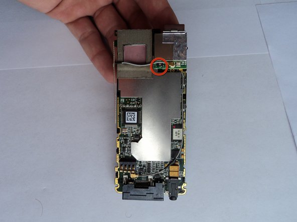

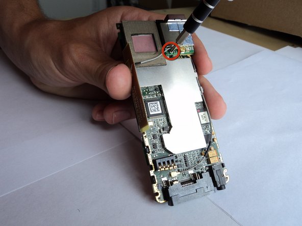

  7. Disassembling Sirius Stiletto 100 Internal Antenna, Internal Antenna: crwdns2935265:07crwdnd2935265:01crwdnd2935265:03crwdne2935265:0 Disassembling Sirius Stiletto 100 Internal Antenna, Internal Antenna: crwdns2935265:07crwdnd2935265:02crwdnd2935265:03crwdne2935265:0 Disassembling Sirius Stiletto 100 Internal Antenna, Internal Antenna: crwdns2935265:07crwdnd2935265:03crwdnd2935265:03crwdne2935265:0
    • Flip the circuit board over to look at the back side, so that LCD screen is facing away from you.
    • Use a Phillip's head screwdriver to remove the screw from the back of the internal antenna.

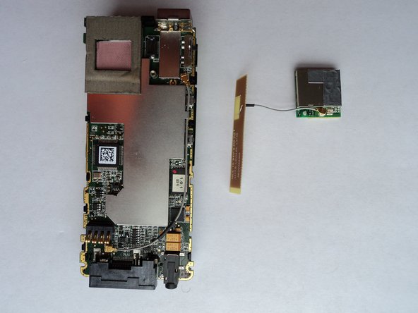

  8. Disassembling Sirius Stiletto 100 Internal Antenna: crwdns2935265:08crwdnd2935265:01crwdnd2935265:02crwdne2935265:0 Disassembling Sirius Stiletto 100 Internal Antenna: crwdns2935265:08crwdnd2935265:02crwdnd2935265:02crwdne2935265:0
    • Use your fingers to pry the internal antenna off of the circuit board. You may need to wiggle it back and forth to successfully remove it.
    • Woohoo! You have removed the internal antenna!
