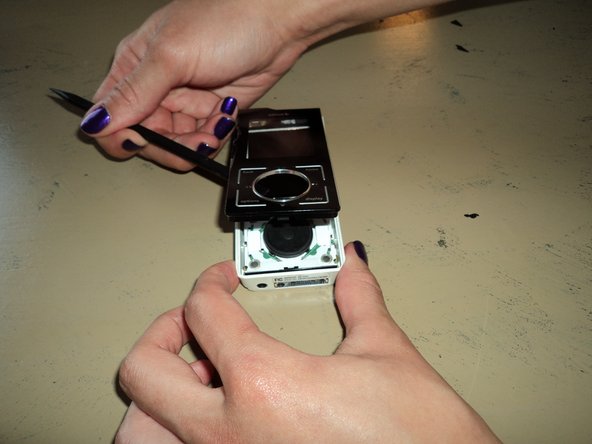

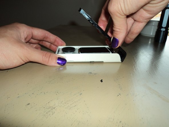

  3. Disassembling Sirius Stiletto 100 Front Cover: crwdns2935265:03crwdnd2935265:01crwdnd2935265:03crwdne2935265:0 Disassembling Sirius Stiletto 100 Front Cover: crwdns2935265:03crwdnd2935265:02crwdnd2935265:03crwdne2935265:0 Disassembling Sirius Stiletto 100 Front Cover: crwdns2935265:03crwdnd2935265:03crwdnd2935265:03crwdne2935265:0
    • Remove the front cover.
    • First, insert a small pry bar where the black front cover and white back cover meet.
    • Begin prying the black plastic up, slowing moving around to the bottom and other side.
    • At an angle, carefully pull up on the front cover separate the two pieces.
    • Excellent! Now you have removed the front cover!
