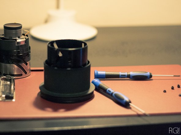

    • Camera lens are delicate and intricate. Be careful with the disassembly and work slowly.
    • Take the lens away from camera
    • DO NOT FORGET: THAT YOU ARE DOING ALL ON YOUR OWN RESPONSIBILITY
  2. Disassembling Sigma 24-70mm F2.8 EX DG Macro Lens Zoom bearing: crwdns2935265:02crwdnd2935265:01crwdnd2935265:02crwdne2935265:0 Disassembling Sigma 24-70mm F2.8 EX DG Macro Lens Zoom bearing: crwdns2935265:02crwdnd2935265:02crwdnd2935265:02crwdne2935265:0
    • Unscrew the top part and detach it.
    • Unjoin cables. Be careful; they're delicate, and easily torn.
    • Try to avoid touching sensitive electronic components.
    • Unfasten the screws that hold the circuit board in place, and separate it from the rest of the lens assembly.
  3. Disassembling Sigma 24-70mm F2.8 EX DG Macro Lens Zoom bearing: crwdns2935265:03crwdnd2935265:01crwdnd2935265:02crwdne2935265:0 Disassembling Sigma 24-70mm F2.8 EX DG Macro Lens Zoom bearing: crwdns2935265:03crwdnd2935265:02crwdnd2935265:02crwdne2935265:0
    • Take away zoom rubber and you will find srews
  4. Disassembling Sigma 24-70mm F2.8 EX DG Macro Lens Zoom bearing: crwdns2935265:04crwdnd2935265:01crwdnd2935265:02crwdne2935265:0 Disassembling Sigma 24-70mm F2.8 EX DG Macro Lens Zoom bearing: crwdns2935265:04crwdnd2935265:02crwdnd2935265:02crwdne2935265:0
    • Keep unscrewing and removing the parts until you reach what you need to fix.
    • Zoom bearing can be taken away by unscrewing its srews.
  5. Disassembling Sigma 24-70mm F2.8 EX DG Macro Lens Zoom bearing: crwdns2935265:05crwdnd2935265:01crwdnd2935265:01crwdne2935265:0
    • Here is one of the parts which was broken, so I go to camera repair shop, and bought that parts. As this was not the only part broken, I had to leave for additional repair.
    • When you finish you can put all back together
