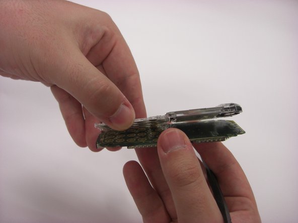

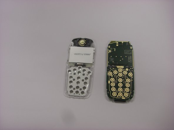

    1. Disassembling Siemens A56 Motherboard from Keypad Interface, Motherboard from Keypad Interface: crwdns2935265:07crwdnd2935265:01crwdnd2935265:03crwdne2935265:0 Disassembling Siemens A56 Motherboard from Keypad Interface, Motherboard from Keypad Interface: crwdns2935265:07crwdnd2935265:02crwdnd2935265:03crwdne2935265:0 Disassembling Siemens A56 Motherboard from Keypad Interface, Motherboard from Keypad Interface: crwdns2935265:07crwdnd2935265:03crwdnd2935265:03crwdne2935265:0
      • Insert the fine-tipped spudger in between the motherboard and the keypad interface.
      • Gently work the spudger across the length of the motherboard.
      • An adhesive exists between the motherboard and the keypad interface.
      • Once loosened, the motherboard should easily separate from the keypad interface.
