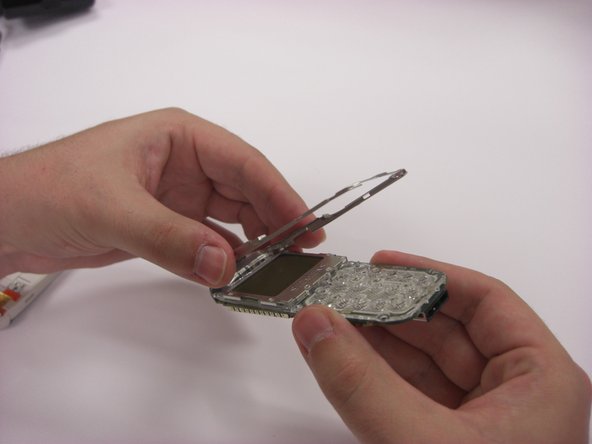

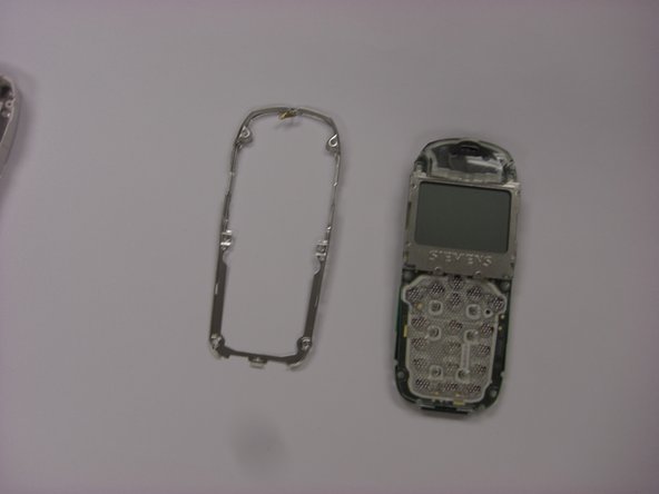

  4. Disassembling Siemens A56 Motherboard Metal Frame, Motherboard Metal Frame: crwdns2935265:04crwdnd2935265:01crwdnd2935265:03crwdne2935265:0 Disassembling Siemens A56 Motherboard Metal Frame, Motherboard Metal Frame: crwdns2935265:04crwdnd2935265:02crwdnd2935265:03crwdne2935265:0 Disassembling Siemens A56 Motherboard Metal Frame, Motherboard Metal Frame: crwdns2935265:04crwdnd2935265:03crwdnd2935265:03crwdne2935265:0
    • Turn over the keypad interface and using the blue plastic opening tool, gently pry the bottom of the metal frame.
    • Once loosened, the metal frame should be able to be lifted from the motherboard.
