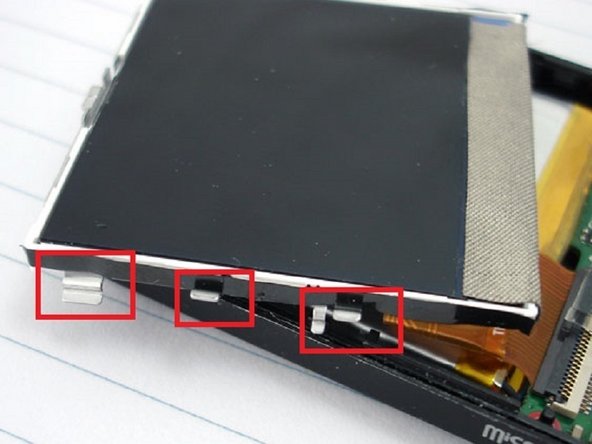

    4. Disassembling SanDisk Sansa Fuze: crwdns2935265:04crwdnd2935265:01crwdnd2935265:02crwdne2935265:0 Disassembling SanDisk Sansa Fuze: crwdns2935265:04crwdnd2935265:02crwdnd2935265:02crwdne2935265:0
      • Remove LCD by releasing the 4 clips on each side of the LCD, be carefully to not damage the LCD
