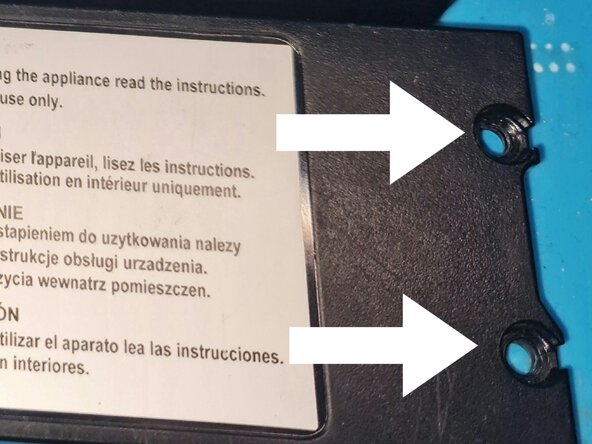

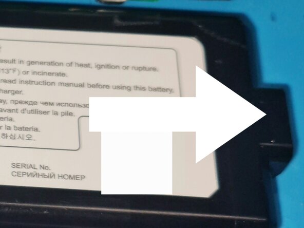

    • Unscrew the two screws on the battery compartment.
    • Lift battery out of the vacum by pulling on the edge the arrow points to.

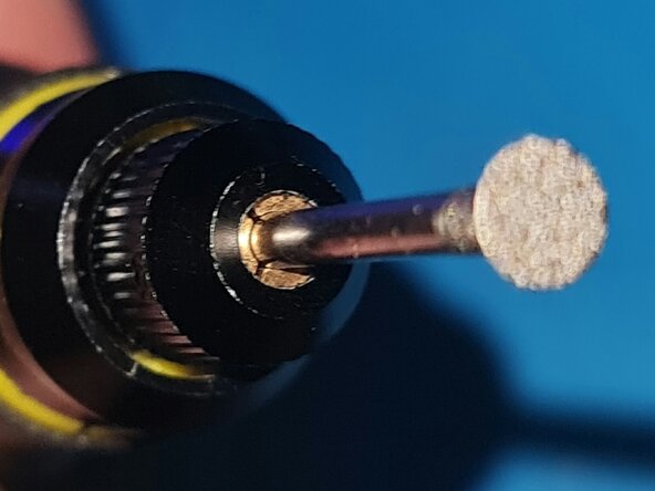

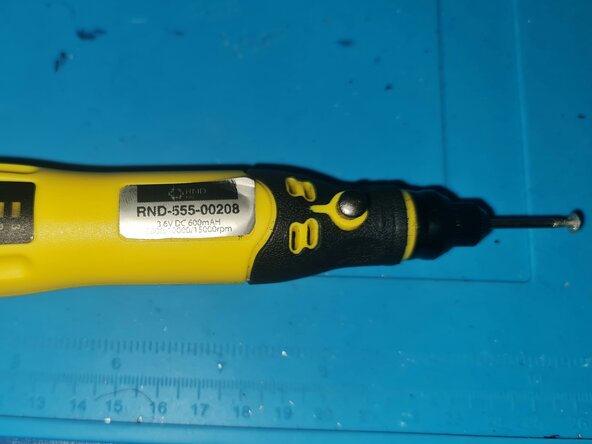

  2. Disassembling Samsung Vacuum Battery VCA-RBT80 VR30T80313W/WA, Cut open the housing: crwdns2935265:02crwdnd2935265:01crwdnd2935265:03crwdne2935265:0 Disassembling Samsung Vacuum Battery VCA-RBT80 VR30T80313W/WA, Cut open the housing: crwdns2935265:02crwdnd2935265:02crwdnd2935265:03crwdne2935265:0 Disassembling Samsung Vacuum Battery VCA-RBT80 VR30T80313W/WA, Cut open the housing: crwdns2935265:02crwdnd2935265:03crwdnd2935265:03crwdne2935265:0

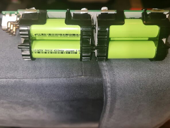

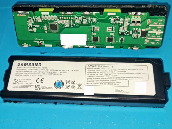

    • Carefully cut in the thin ridge around the battery with a small round blade using something like a motorized grinder. NB! The blade should be very small, you shouldn't cut deeper then a 2-3 milimeters.
    • Take the PCB with the cells out of the housing. NB! The whole assembly is glued behind the assembly to the housing. I bit of prying should loosen it.

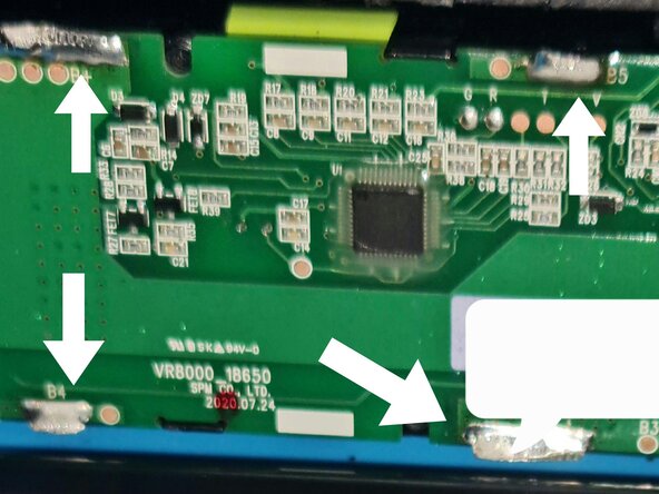

  3. Disassembling Samsung Vacuum Battery VCA-RBT80 VR30T80313W/WA, Desolder and unscrew PCB: crwdns2935265:03crwdnd2935265:01crwdnd2935265:03crwdne2935265:0 Disassembling Samsung Vacuum Battery VCA-RBT80 VR30T80313W/WA, Desolder and unscrew PCB: crwdns2935265:03crwdnd2935265:02crwdnd2935265:03crwdne2935265:0 Disassembling Samsung Vacuum Battery VCA-RBT80 VR30T80313W/WA, Desolder and unscrew PCB: crwdns2935265:03crwdnd2935265:03crwdnd2935265:03crwdne2935265:0

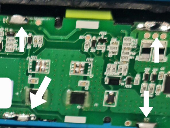

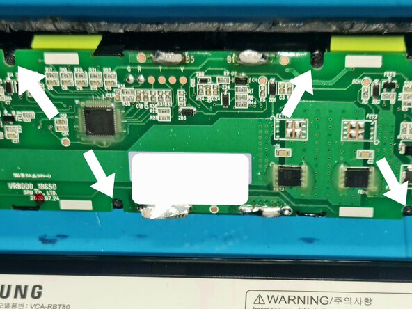

    • Desolder the eight edges around the PCB using a desoldering sucker, desoldering pump or wick. Unscrew the four screws holding the PCB to the plastic that holds the batteries. And remove the PCB from the cells.

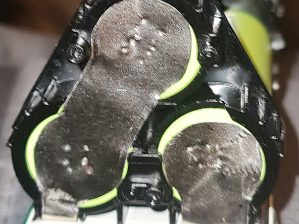

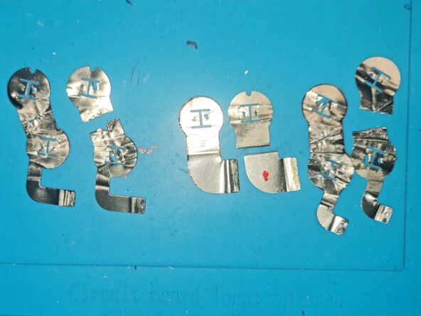

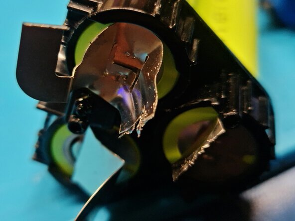

  4. Disassembling Samsung Vacuum Battery VCA-RBT80 VR30T80313W/WA, Disassemble the Cells: crwdns2935265:04crwdnd2935265:01crwdnd2935265:03crwdne2935265:0 Disassembling Samsung Vacuum Battery VCA-RBT80 VR30T80313W/WA, Disassemble the Cells: crwdns2935265:04crwdnd2935265:02crwdnd2935265:03crwdne2935265:0 Disassembling Samsung Vacuum Battery VCA-RBT80 VR30T80313W/WA, Disassemble the Cells: crwdns2935265:04crwdnd2935265:03crwdnd2935265:03crwdne2935265:0

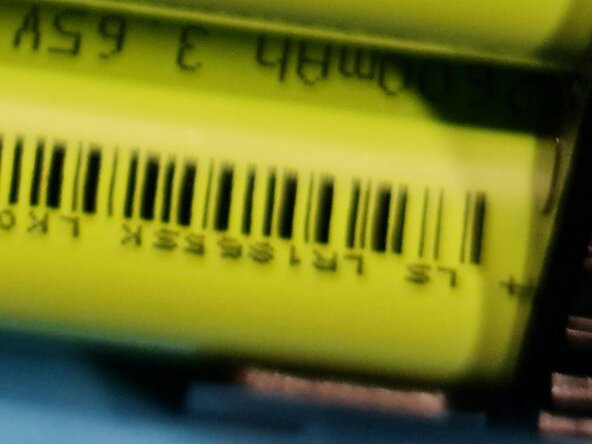

    • Disassemble the cells from the plastic holders, twist the tin off the old cell's and flaten them out again on a flat surface. Tape the ones you had to cut. This is for drawing them out on the tin plate.
    • Draw them out and cut them with a scissor or metal shears. It doesn't have to be perfect as long as it's somewhat the same.

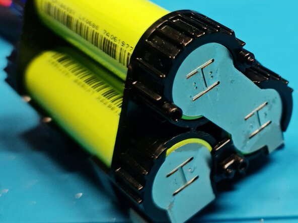

  5. Disassembling Samsung Vacuum Battery VCA-RBT80 VR30T80313W/WA, Put together and spot weld: crwdns2935265:05crwdnd2935265:01crwdnd2935265:02crwdne2935265:0 Disassembling Samsung Vacuum Battery VCA-RBT80 VR30T80313W/WA, Put together and spot weld: crwdns2935265:05crwdnd2935265:02crwdnd2935265:02crwdne2935265:0
    • If you want to check the cells, go ahead. But chances are one or more are dead cells. If that is the case, then I recommend changing all the cells, preferably with new cells from the same batch, just to synchronize the lifetime of the cells in battery.
    • Put new cells in the plastic holders in the same orientation as the old ones. Should be two similar on the bottom and the one on the top the other way.
    • Now spot weld the new tin plates to the new cells. Fine cut the tin plates if needed. If you look underneath the PCB you should see where b+ and b- are. The batteries are all in series so the bottom cell (+ or -) should correspond to b+ and b-.
