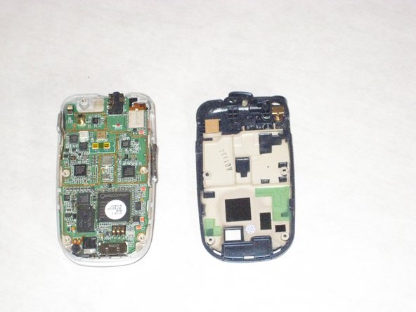

  3. Disassembling Samsung SPH-A760 Screen, Logic Board: crwdns2935265:03crwdnd2935265:01crwdnd2935265:01crwdne2935265:0
    • Remove the five screws as shown.

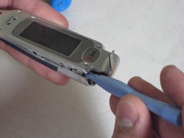

  4. Disassembling Samsung SPH-A760 Screen: crwdns2935265:04crwdnd2935265:01crwdnd2935265:01crwdne2935265:0
    • Carefully pry the back plate off.

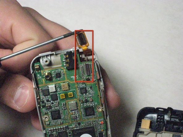

    • Carefully detach golden screen connector.

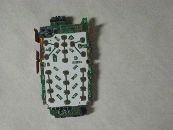

  6. Disassembling Samsung SPH-A760 Screen: crwdns2935265:06crwdnd2935265:01crwdnd2935265:02crwdne2935265:0 Disassembling Samsung SPH-A760 Screen: crwdns2935265:06crwdnd2935265:02crwdnd2935265:02crwdne2935265:0
    • Pop out the logic board with spudger.
    • Caution: Do not touch with bare hands, use tweezers or wash hands before contact.
  7. Disassembling Samsung SPH-A760 Screen: crwdns2935265:07crwdnd2935265:01crwdnd2935265:02crwdne2935265:0 Disassembling Samsung SPH-A760 Screen: crwdns2935265:07crwdnd2935265:02crwdnd2935265:02crwdne2935265:0
    • Place the logic board on a clean tray.

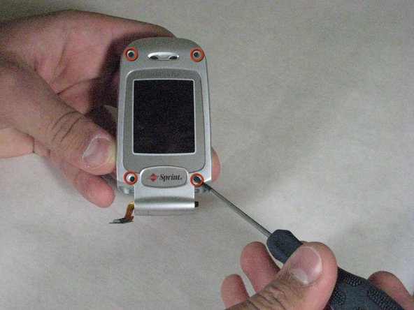

  9. Disassembling Samsung SPH-A760 Screen: crwdns2935265:09crwdnd2935265:01crwdnd2935265:03crwdne2935265:0 Disassembling Samsung SPH-A760 Screen: crwdns2935265:09crwdnd2935265:02crwdnd2935265:03crwdne2935265:0 Disassembling Samsung SPH-A760 Screen: crwdns2935265:09crwdnd2935265:03crwdnd2935265:03crwdne2935265:0
    • Remove the four screws as shown
    • Use the spudger to pry it open, excessive force may be necessary.

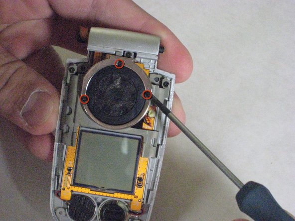

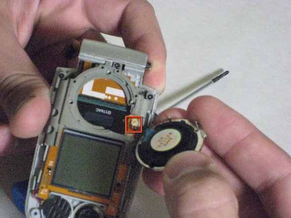

    • Remove the three screws that hold the big speaker
    • Caution: The wires are attached to the screen and should be removed with care.

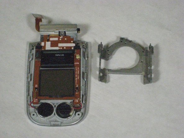

  11. Disassembling Samsung SPH-A760 Screen, Screen: crwdns2935265:011crwdnd2935265:01crwdnd2935265:02crwdne2935265:0 Disassembling Samsung SPH-A760 Screen, Screen: crwdns2935265:011crwdnd2935265:02crwdnd2935265:02crwdne2935265:0
    • Remove the three screws as shown.
    • Pull off the metal bracket.
  12. Disassembling Samsung SPH-A760 Screen: crwdns2935265:012crwdnd2935265:01crwdnd2935265:03crwdne2935265:0 Disassembling Samsung SPH-A760 Screen: crwdns2935265:012crwdnd2935265:02crwdnd2935265:03crwdne2935265:0 Disassembling Samsung SPH-A760 Screen: crwdns2935265:012crwdnd2935265:03crwdnd2935265:03crwdne2935265:0

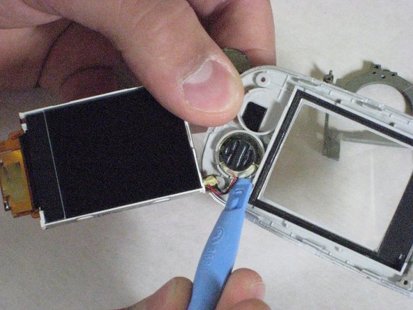

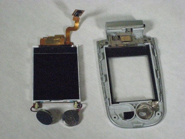

    • Use the spudger to pop off the screen.
    • Pop off the Microphone/Speaker as well.
    • Place all of the components on a clean tray and clean environment.
