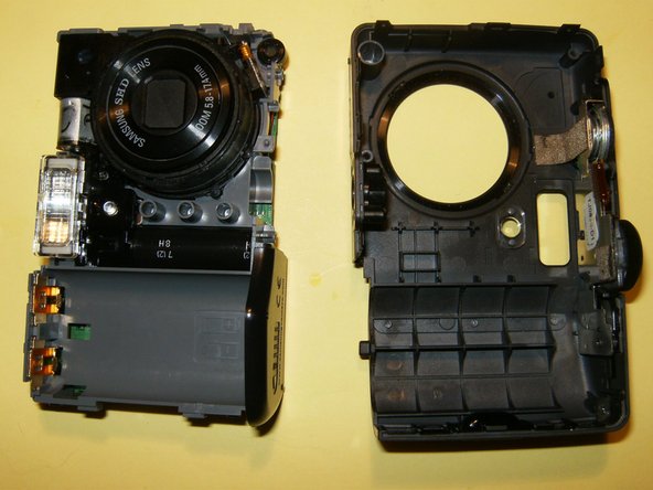

    • Split the case from the battery compartment down. You can use an opening tool or your fingernails to accomplish that.

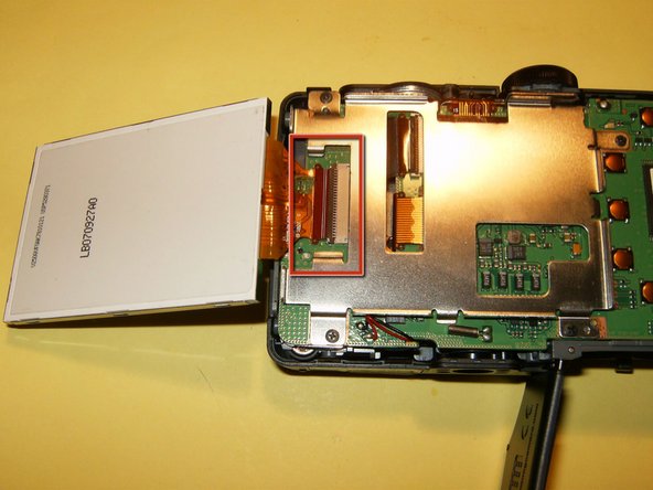

    • With the case split, you can see the LCD in its holder. The LCD is simply laid into the holder.
    • Gently remove the LCD from the holder and just flip it to the side. Do not remove it yet. You will have to loosen the clip on the connector. Use your fingernails to move it in the opposite direction from the LCD, this will open it up.

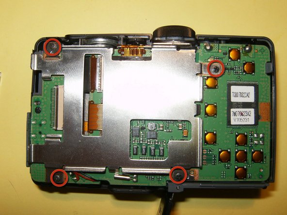

    • Remove the four screws from the LCD holder.
  4. Disassembling Samsung S730 Logic Board: crwdns2935265:04crwdnd2935265:01crwdnd2935265:03crwdne2935265:0 Disassembling Samsung S730 Logic Board: crwdns2935265:04crwdnd2935265:02crwdnd2935265:03crwdne2935265:0 Disassembling Samsung S730 Logic Board: crwdns2935265:04crwdnd2935265:03crwdnd2935265:03crwdne2935265:0
    • LCD holder removed from logic board

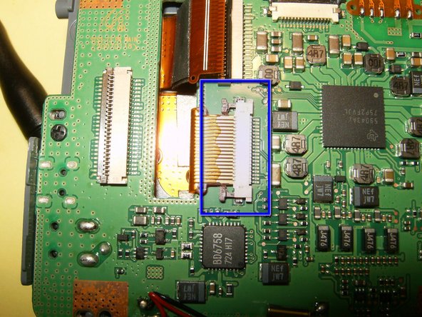

    • disconnect the ribbon cable from the logic board. This one requires to move the brown tabs on the left and right hands side in an upward direction. They should just slide up by about an 1/8th of an inch. this will free the ribbon cable.
    • With the ribbon cable disconnected, remove the front case.
  5. Disassembling Samsung S730 Logic Board: crwdns2935265:05crwdnd2935265:01crwdnd2935265:03crwdne2935265:0 Disassembling Samsung S730 Logic Board: crwdns2935265:05crwdnd2935265:02crwdnd2935265:03crwdne2935265:0 Disassembling Samsung S730 Logic Board: crwdns2935265:05crwdnd2935265:03crwdnd2935265:03crwdne2935265:0

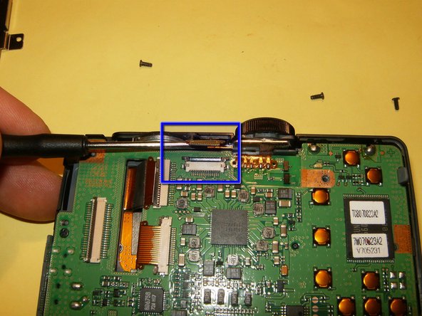

    • Remove the CCD and the lens ribbon cable from the connectors.
    • To release the CCD cable, gently slide the brown clips on either side to the left. This will release the cable.

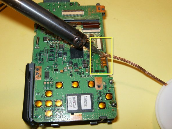

    • Desolder the connector from the top PCB. Use a soldering wick and flux to make the task easier.

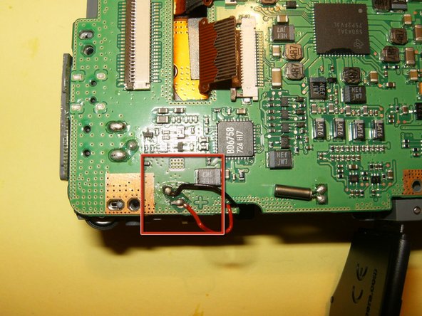

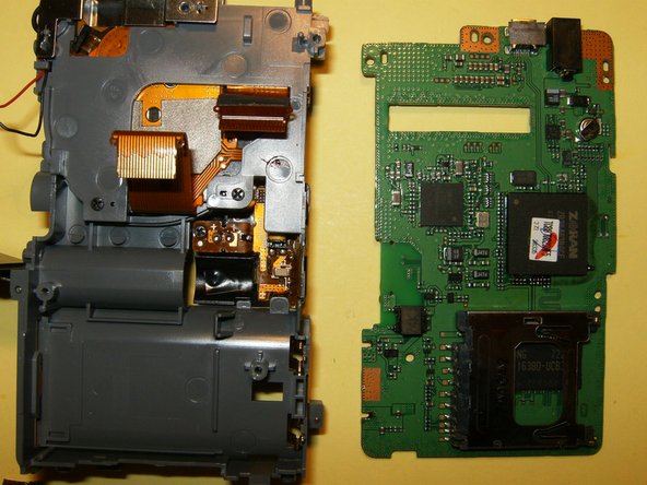

    • Desolder the battery connectors.
    • Desolder the black and red wire.
    • Remove the logic board from the midframe.
