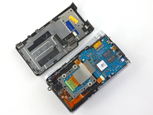

  11. Disassembling Samsung NX3000: crwdns2935265:011crwdnd2935265:01crwdnd2935265:03crwdne2935265:0 Disassembling Samsung NX3000: crwdns2935265:011crwdnd2935265:02crwdnd2935265:03crwdne2935265:0 Disassembling Samsung NX3000: crwdns2935265:011crwdnd2935265:03crwdnd2935265:03crwdne2935265:0
    • Use the flat end of a spudger to pry the flat topped connector straight up from the motherboard.
    • Remove the back case.

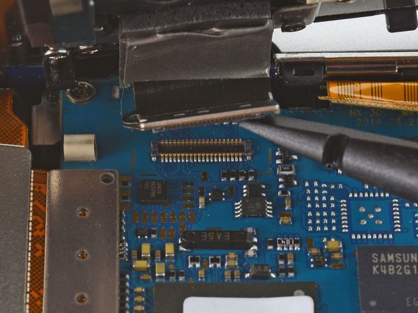

  14. Disassembling Samsung NX3000: crwdns2935265:014crwdnd2935265:01crwdnd2935265:03crwdne2935265:0 Disassembling Samsung NX3000: crwdns2935265:014crwdnd2935265:02crwdnd2935265:03crwdne2935265:0 Disassembling Samsung NX3000: crwdns2935265:014crwdnd2935265:03crwdnd2935265:03crwdne2935265:0
    • Use the flat end of a spudger to disconnect the large ribbon cable by prying its metal connector straight up from the motherboard.

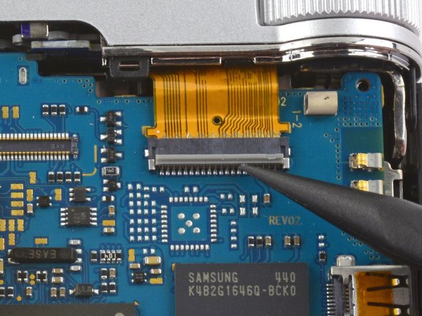

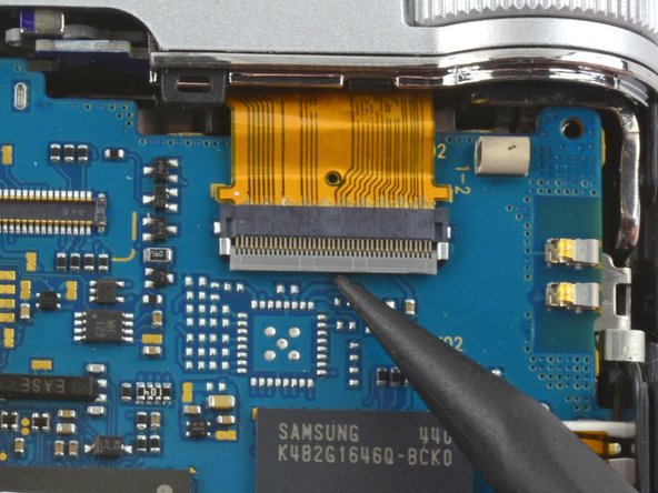

  15. Disassembling Samsung NX3000: crwdns2935265:015crwdnd2935265:01crwdnd2935265:03crwdne2935265:0 Disassembling Samsung NX3000: crwdns2935265:015crwdnd2935265:02crwdnd2935265:03crwdne2935265:0 Disassembling Samsung NX3000: crwdns2935265:015crwdnd2935265:03crwdnd2935265:03crwdne2935265:0
    • Use the pointed tip of a spudger to unlock the ZIF connector by flipping the black bar straight up from the motherboard.
  16. Disassembling Samsung NX3000: crwdns2935265:016crwdnd2935265:01crwdnd2935265:02crwdne2935265:0 Disassembling Samsung NX3000: crwdns2935265:016crwdnd2935265:02crwdnd2935265:02crwdne2935265:0
    • Insert the pointed end of a spudger into the hole on the ribbon cable.
    • Pull the ribbon cable straight out of the ZIF connector.

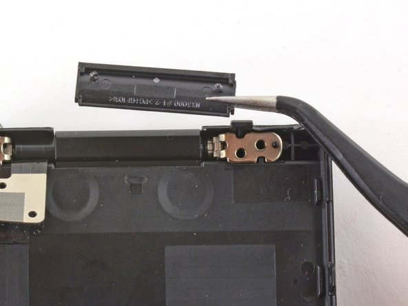

  32. Disassembling Samsung NX3000: crwdns2935265:032crwdnd2935265:01crwdnd2935265:02crwdne2935265:0 Disassembling Samsung NX3000: crwdns2935265:032crwdnd2935265:02crwdnd2935265:02crwdne2935265:0
    • Use tweezers to remove the plastic cover on the LCD hinge.
