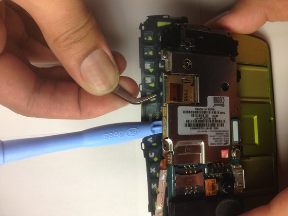

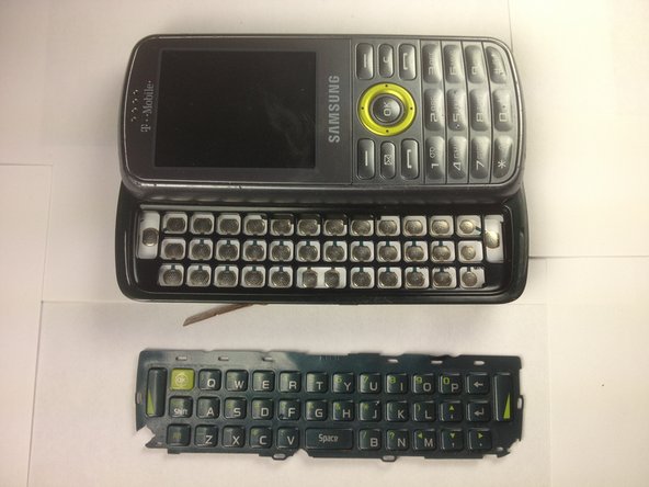

  4. Disassembling Samsung Gravity SGH-T459 Keypad, Keypad: crwdns2935265:04crwdnd2935265:01crwdnd2935265:03crwdne2935265:0 Disassembling Samsung Gravity SGH-T459 Keypad, Keypad: crwdns2935265:04crwdnd2935265:02crwdnd2935265:03crwdne2935265:0 Disassembling Samsung Gravity SGH-T459 Keypad, Keypad: crwdns2935265:04crwdnd2935265:03crwdnd2935265:03crwdne2935265:0
    • Gently remove the two button contacts with your fingers.
    • Use a plastic prying tool to pry the keypad away from the circuit board.
    • Use tweezers to gently remove the keypad.
