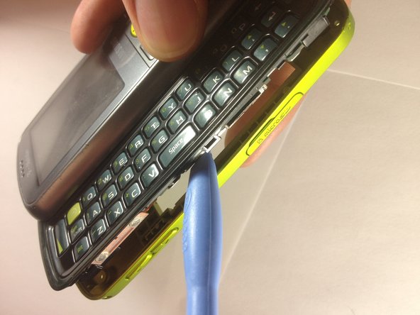

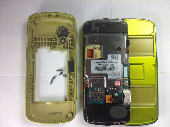

  3. Disassembling Samsung Gravity SGH-T459 1.3 megapixel camera, Rear Case: crwdns2935265:03crwdnd2935265:01crwdnd2935265:03crwdne2935265:0 Disassembling Samsung Gravity SGH-T459 1.3 megapixel camera, Rear Case: crwdns2935265:03crwdnd2935265:02crwdnd2935265:03crwdne2935265:0 Disassembling Samsung Gravity SGH-T459 1.3 megapixel camera, Rear Case: crwdns2935265:03crwdnd2935265:03crwdnd2935265:03crwdne2935265:0
    • Hold the cell phone steady with one hand. With the other hand, use a Phillips screwdriver to remove all 6 screws around the edges of the rear case.
    • Slide the phone open.
    • Use a plastic prying tool to pry open the edge of the green trim near the space bar of the keypad. You should hear the rear case unsnap.
    • Gently lift and remove the rear case from the cell phone.

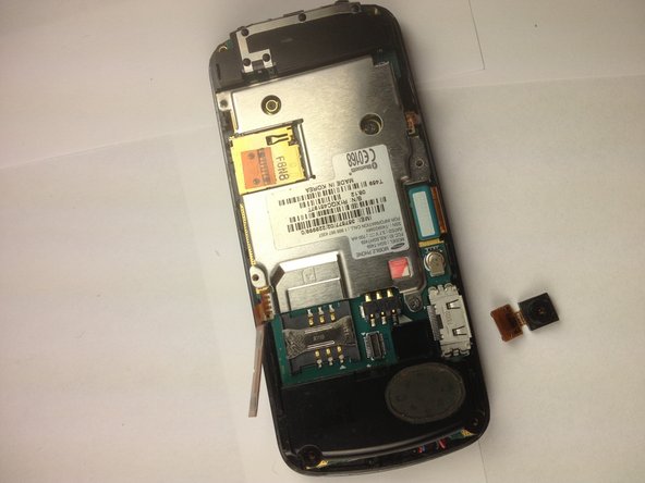

  4. Disassembling Samsung Gravity SGH-T459 1.3 megapixel camera, 1.3 megapixel camera: crwdns2935265:04crwdnd2935265:01crwdnd2935265:02crwdne2935265:0 Disassembling Samsung Gravity SGH-T459 1.3 megapixel camera, 1.3 megapixel camera: crwdns2935265:04crwdnd2935265:02crwdnd2935265:02crwdne2935265:0
    • Gently lift and remove the 1.3 megapixel camera with your fingers.
