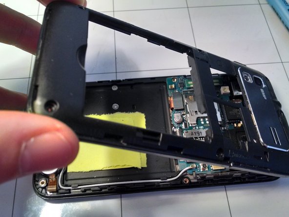

    4. Disassembling Samsung Captivate Glide Phone, Prying Up The Back: crwdns2935265:04crwdnd2935265:01crwdnd2935265:03crwdne2935265:0 Disassembling Samsung Captivate Glide Phone, Prying Up The Back: crwdns2935265:04crwdnd2935265:02crwdnd2935265:03crwdne2935265:0 Disassembling Samsung Captivate Glide Phone, Prying Up The Back: crwdns2935265:04crwdnd2935265:03crwdnd2935265:03crwdne2935265:0
      • Plastic molded clips hold the back panel in place and can be removed by first inserting the plastic opening tool into the indicated locations and prying up to pop the back up.
      • Then using a wider lipped plastic opening tool pry the outside of the housing up and the back will remove cleanly.

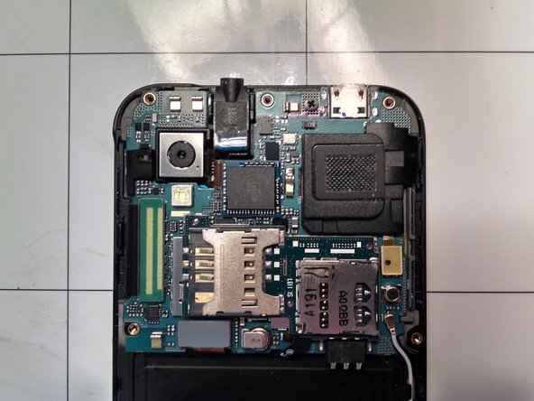

    5. Disassembling Samsung Captivate Glide Phone, The Phone's Innards: crwdns2935265:05crwdnd2935265:01crwdnd2935265:03crwdne2935265:0 Disassembling Samsung Captivate Glide Phone, The Phone's Innards: crwdns2935265:05crwdnd2935265:02crwdnd2935265:03crwdne2935265:0 Disassembling Samsung Captivate Glide Phone, The Phone's Innards: crwdns2935265:05crwdnd2935265:03crwdnd2935265:03crwdne2935265:0
      • Shown here are internals of the phone.

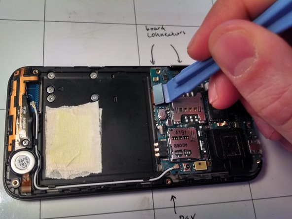

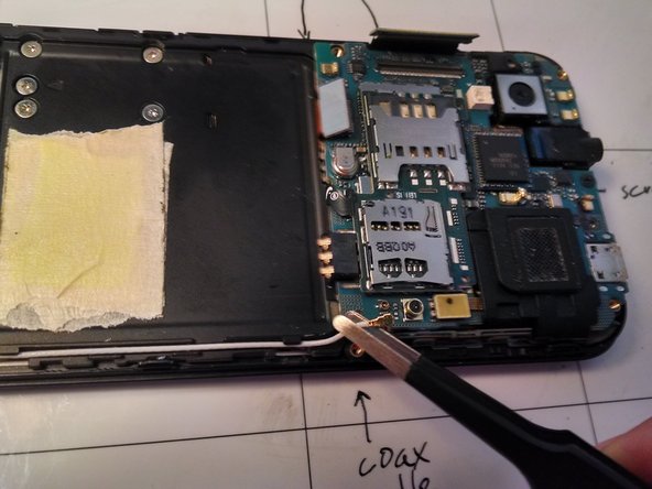

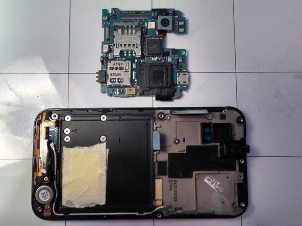

    6. Disassembling Samsung Captivate Glide Phone, Motherboard Removal: crwdns2935265:06crwdnd2935265:01crwdnd2935265:03crwdne2935265:0 Disassembling Samsung Captivate Glide Phone, Motherboard Removal: crwdns2935265:06crwdnd2935265:02crwdnd2935265:03crwdne2935265:0 Disassembling Samsung Captivate Glide Phone, Motherboard Removal: crwdns2935265:06crwdnd2935265:03crwdnd2935265:03crwdne2935265:0
      • In order to remove the motherboard remove a single screw with the phillips #00 screwdriver, gently pry up the two pop connectors on the board, and finally pull off the coaxial cable.
    7. Disassembling Samsung Captivate Glide Phone, Motherboard Removal: crwdns2935265:07crwdnd2935265:01crwdnd2935265:02crwdne2935265:0 Disassembling Samsung Captivate Glide Phone, Motherboard Removal: crwdns2935265:07crwdnd2935265:02crwdnd2935265:02crwdne2935265:0
      • The motherboard comes out of the phone body easily.

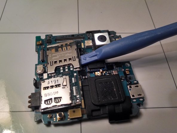

    8. Disassembling Samsung Captivate Glide Phone, Daughterboard Removal: crwdns2935265:08crwdnd2935265:01crwdnd2935265:02crwdne2935265:0 Disassembling Samsung Captivate Glide Phone, Daughterboard Removal: crwdns2935265:08crwdnd2935265:02crwdnd2935265:02crwdne2935265:0
      • The modular pieces of the motherboard are easily removed and replaced as needed.
      • First the daughter board containing the SIM card and microSD card can be removed by disconnecting a single pop connector from the board and then gently pry the daughter board up and it will come loose. It is held down to the motherboard by the stamped metal board level shielding cages.

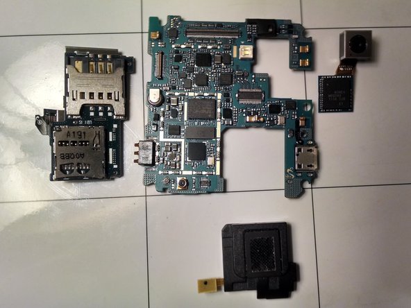

    11. Disassembling Samsung Captivate Glide Phone, The Disassembled Motherboard: crwdns2935265:011crwdnd2935265:01crwdnd2935265:02crwdne2935265:0 Disassembling Samsung Captivate Glide Phone, The Disassembled Motherboard: crwdns2935265:011crwdnd2935265:02crwdnd2935265:02crwdne2935265:0
      • Shown here are all the pieces of the motherboard.

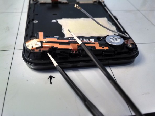

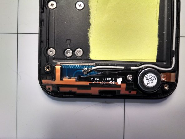

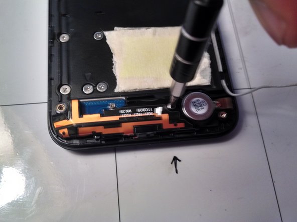

    12. Disassembling Samsung Captivate Glide Phone, Antenna Module Removal: crwdns2935265:012crwdnd2935265:01crwdnd2935265:03crwdne2935265:0 Disassembling Samsung Captivate Glide Phone, Antenna Module Removal: crwdns2935265:012crwdnd2935265:02crwdnd2935265:03crwdne2935265:0 Disassembling Samsung Captivate Glide Phone, Antenna Module Removal: crwdns2935265:012crwdnd2935265:03crwdnd2935265:03crwdne2935265:0
      • The antenna module can be removed by disconnecting the coaxial cable and a single phillips #00 screw.
      • The antenna module can be prying upward at the location indicated.
    13. Disassembling Samsung Captivate Glide Phone, Antenna Module: crwdns2935265:013crwdnd2935265:01crwdnd2935265:01crwdne2935265:0
      • Shown here is the antenna module.
