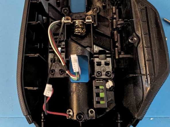

  3. Disassembling Razer Basilisk X Hyperspeed Top Case, Remove the Top: crwdns2935265:04crwdnd2935265:01crwdnd2935265:02crwdne2935265:0 Disassembling Razer Basilisk X Hyperspeed Top Case, Remove the Top: crwdns2935265:04crwdnd2935265:02crwdnd2935265:02crwdne2935265:0
    • First remove battery, after that, lift it from the bottom using your nail or a prying tool from the gap at the bottom. Open it carefully, since there are wire connectors. Carefully disconnect from the plastic to avoid damage, DO NOT PULL FROM THE WIRES.
  4. Disassembling Razer Basilisk X Hyperspeed Top Case, Admire your work: crwdns2935265:05crwdnd2935265:01crwdnd2935265:01crwdne2935265:0
    • If you need to remove the board, you need a 00 Philips bit for the screws on the board and a 1 Philips bit for the screws on the side buttons, other than that, you have full access to the board.
