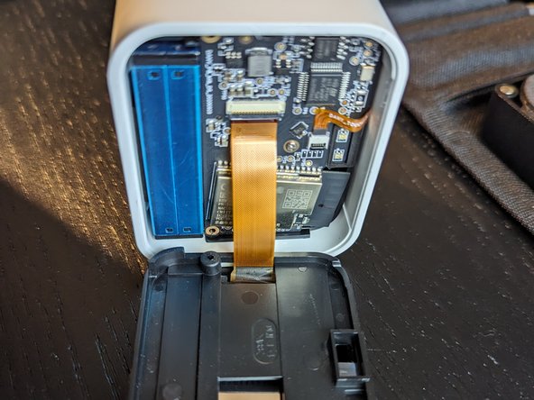

  3. Disassembling Qingping Air Monitor Lite CGDN1, Disconnect screen: crwdns2935265:03crwdnd2935265:01crwdnd2935265:03crwdne2935265:0 Disassembling Qingping Air Monitor Lite CGDN1, Disconnect screen: crwdns2935265:03crwdnd2935265:02crwdnd2935265:03crwdne2935265:0 Disassembling Qingping Air Monitor Lite CGDN1, Disconnect screen: crwdns2935265:03crwdnd2935265:03crwdnd2935265:03crwdne2935265:0
    • Lift the small black ledge to remove the flat cable of the screen. Orange circle

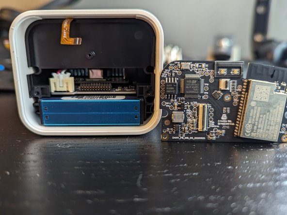

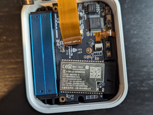

  4. Disassembling Qingping Air Monitor Lite CGDN1, Remove main PCB: crwdns2935265:04crwdnd2935265:01crwdnd2935265:02crwdne2935265:0 Disassembling Qingping Air Monitor Lite CGDN1, Remove main PCB: crwdns2935265:04crwdnd2935265:02crwdnd2935265:02crwdne2935265:0
    • Disconnect the flat cable of the touch sensor by lifting the little black ledge, see the orange circle.
    • One screw holding the PCB, green circle

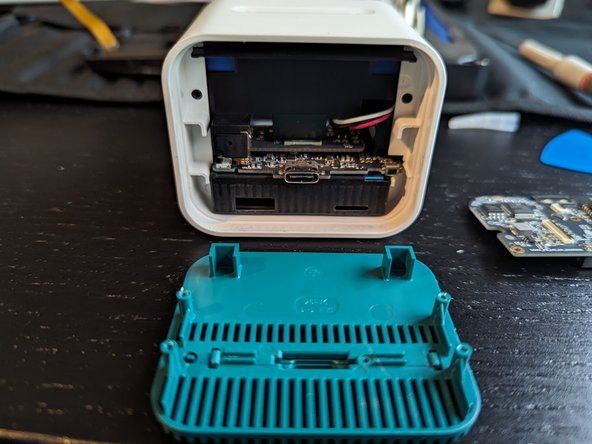

  5. Disassembling Qingping Air Monitor Lite CGDN1, Open the back: crwdns2935265:05crwdnd2935265:01crwdnd2935265:02crwdne2935265:0 Disassembling Qingping Air Monitor Lite CGDN1, Open the back: crwdns2935265:05crwdnd2935265:02crwdnd2935265:02crwdne2935265:0
    • 4 Philips screws hold the back in place.
    • You'll need a very long/narrow bit to reach these screws!

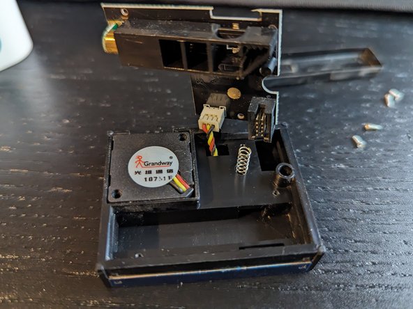

  6. Disassembling Qingping Air Monitor Lite CGDN1, Remove sensors & battery: crwdns2935265:06crwdnd2935265:01crwdnd2935265:01crwdne2935265:0
    • You can slide the complete inner parts to the front.

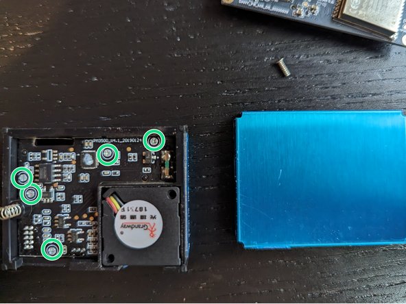

  7. Disassembling Qingping Air Monitor Lite CGDN1, Dismanteling the PM sensor: crwdns2935265:07crwdnd2935265:01crwdnd2935265:03crwdne2935265:0 Disassembling Qingping Air Monitor Lite CGDN1, Dismanteling the PM sensor: crwdns2935265:07crwdnd2935265:02crwdnd2935265:03crwdne2935265:0 Disassembling Qingping Air Monitor Lite CGDN1, Dismanteling the PM sensor: crwdns2935265:07crwdnd2935265:03crwdnd2935265:03crwdne2935265:0
    • Sensor is held by the 10 pin connector
    • Don't let the springs jump away
    • By slightly bending the cover you can lift the cover from the sensor housing
    • 5 little philips screw hold the sesnor PCB in place. To access the fan connector you have to remove the pcb
