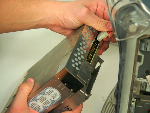

    • Pull the drive out to allow access to the power and ribbon cables. Do not fully remove.
    • Remove both the power and ribbon cable.

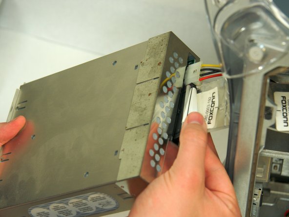

  5. Disassembling Power Mac G4 M5183 DVD-ROM Drive, DVD-ROM Drive: crwdns2935265:05crwdnd2935265:01crwdnd2935265:03crwdne2935265:0 Disassembling Power Mac G4 M5183 DVD-ROM Drive, DVD-ROM Drive: crwdns2935265:05crwdnd2935265:02crwdnd2935265:03crwdne2935265:0 Disassembling Power Mac G4 M5183 DVD-ROM Drive, DVD-ROM Drive: crwdns2935265:05crwdnd2935265:03crwdnd2935265:03crwdne2935265:0
    • Remove DVD drive from the drive bay.
    • Lift the two metal tabs on the back of the shielding and remove.
    • Remove the four screws on the bottom of the drive with the Phillips #1 screwdriver.
    • Slide out DVD drive.
