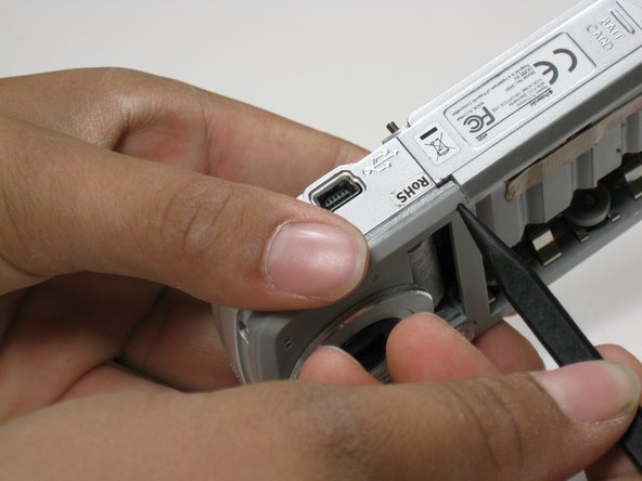

    • Use the pointed end of a spudger to push the push-pin partly through.
  10. Disassembling Polaroid a520 Battery Cover: crwdns2935265:010crwdnd2935265:01crwdnd2935265:01crwdne2935265:0
    • From the other side pull the pin all the way out. The battery cover will fall off.
