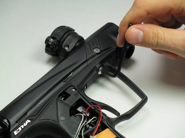

    • Firmly grasp hold of the ring on the bottom of the 90 degree silver fitting on the front of the gun.
    • Pull hard, but slowly, on the macroline where it comes out of silver piece until it comes out.
    • The macroline is the black hose connecting the regulator to the tank connection.

    • Use the 5/64" hex key to remove the screw shown.
    • Remove the grip panel by gently holding the bottom of the panel and lifting the panel off.
    • If you are only replacing the battery, skip the next step.
    • The screws in this guide are interchangeable with those shown in the Eyes replacement guide.

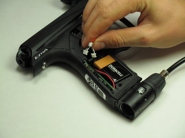

    • Carefully remove the 9V battery and connector.
    • Remove the 9V battery from the connector.
  6. Disassembling Planet Eclipse Etha Frame, Frame: crwdns2935265:06crwdnd2935265:01crwdnd2935265:02crwdne2935265:0 Disassembling Planet Eclipse Etha Frame, Frame: crwdns2935265:06crwdnd2935265:02crwdnd2935265:02crwdne2935265:0
    • Carefully disconnect the three connectors from the circuit board.
    • Don't worry about remembering which direction the connectors go in, they will not fit in the board in the wrong direction.
