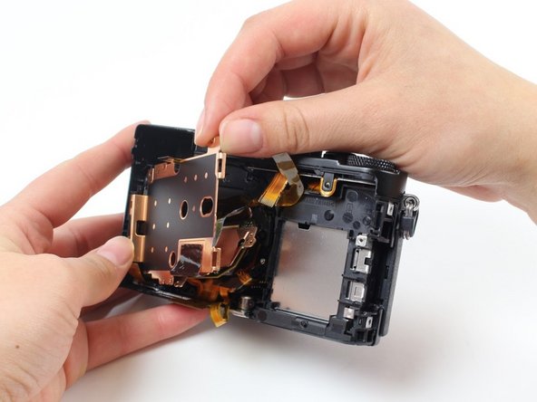

    5. Disassembling Panasonic LUMIX DMC-LX100: crwdns2935265:08crwdnd2935265:01crwdnd2935265:01crwdne2935265:0
      • There may be adhesive holding the back on, so pry carefully to not break any of the ribbon cables underneath.
      • Pry off the back of the camera using a spudger starting from the top right side of the LCD screen.

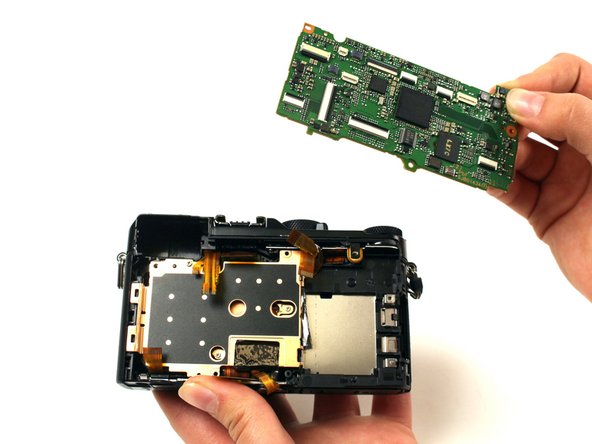

    4. Disassembling Panasonic LUMIX DMC-LX100: crwdns2935265:014crwdnd2935265:01crwdnd2935265:02crwdne2935265:0 Disassembling Panasonic LUMIX DMC-LX100: crwdns2935265:014crwdnd2935265:02crwdnd2935265:02crwdne2935265:0
      • Start at the top of the camera and use the plastic spudger to pry the motherboard out of the camera.

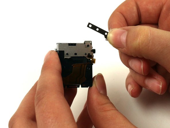

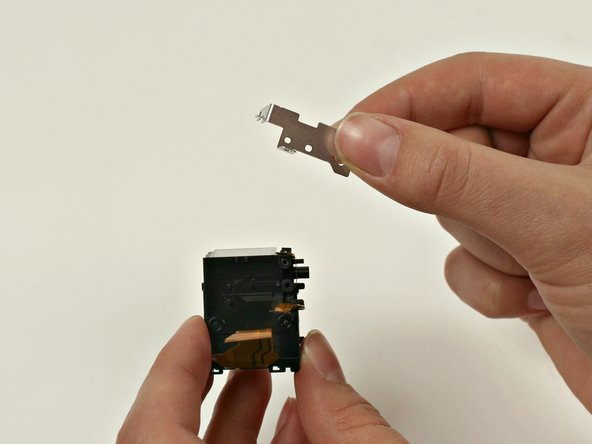

      • Take the viewfinder you took out earlier and pull the small metal piece off of it.
    2. Disassembling Panasonic LUMIX DMC-LX100: crwdns2935265:016crwdnd2935265:01crwdnd2935265:02crwdne2935265:0 Disassembling Panasonic LUMIX DMC-LX100: crwdns2935265:016crwdnd2935265:02crwdnd2935265:02crwdne2935265:0

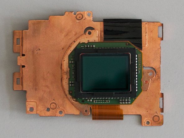

    3. Disassembling Panasonic LUMIX DMC-LX100: crwdns2935265:017crwdnd2935265:01crwdnd2935265:03crwdne2935265:0 Disassembling Panasonic LUMIX DMC-LX100: crwdns2935265:017crwdnd2935265:02crwdnd2935265:03crwdne2935265:0 Disassembling Panasonic LUMIX DMC-LX100: crwdns2935265:017crwdnd2935265:03crwdnd2935265:03crwdne2935265:0
      • Use a Phillips #000 screwdriver to remove the three 3.5 mm screws.
      • Use a Phillips #000 screwdriver to remove the three 3 mm screws.
      • In some models these may be T3 or T4 Torx screws.
      • Gently pull the copper plate towards you to remove it.
      • The sensor is attached to the copper plate and will come out with the copper plate. The thin, red glass plate glued to the front of the sensor is the infrared filter.

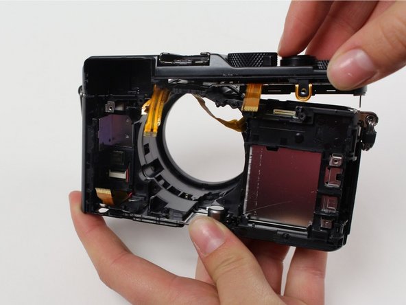

      • Gently pull the top piece off the camera.
    8. Disassembling Panasonic LUMIX DMC-LX100: crwdns2935265:022crwdnd2935265:01crwdnd2935265:03crwdne2935265:0 Disassembling Panasonic LUMIX DMC-LX100: crwdns2935265:022crwdnd2935265:02crwdnd2935265:03crwdne2935265:0 Disassembling Panasonic LUMIX DMC-LX100: crwdns2935265:022crwdnd2935265:03crwdnd2935265:03crwdne2935265:0
      • Use a Phillips #000 screwdriver to remove all five 4.1mm screws from the piece you took off in the previous step.
      • Gently pull the metal cover until it turns 180 degrees.
      • The metal cover will not come all the way off because it will still be attached by ribbon cables.

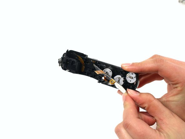

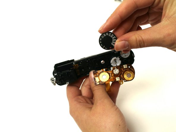

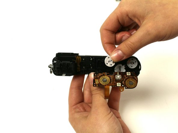

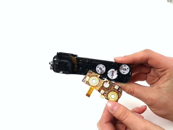

    9. Disassembling Panasonic LUMIX DMC-LX100: crwdns2935265:023crwdnd2935265:01crwdnd2935265:03crwdne2935265:0 Disassembling Panasonic LUMIX DMC-LX100: crwdns2935265:023crwdnd2935265:02crwdnd2935265:03crwdne2935265:0 Disassembling Panasonic LUMIX DMC-LX100: crwdns2935265:023crwdnd2935265:03crwdnd2935265:03crwdne2935265:0
      • To remove a knob, remove the screws on the white piece underneath the knob you want to remove with a Phillips #000 screwdriver.
      • The left knob is being removed in this step but the process is the same for any of the knobs pictured in this step.
      • Pull the corresponding white piece off.
      • Flip the piece over and pull the corresponding black knob off the top of the camera.
    10. Disassembling Panasonic LUMIX DMC-LX100: crwdns2935265:024crwdnd2935265:01crwdnd2935265:01crwdne2935265:0
