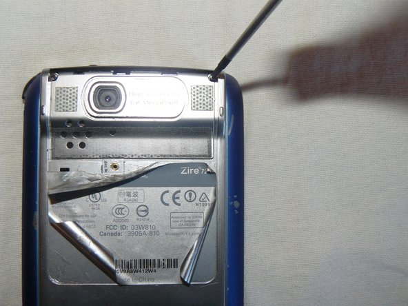

    • Power off your Zire 72 and turn the unit over.
    • Remove the two screws on the bottom of the rear of the unit.
    • Peel back the information sticker.

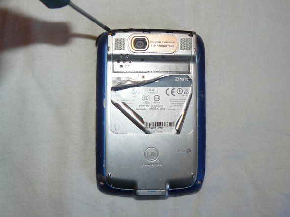

    • Remove the one screw that connects the metal panel to the body of the Zire72.
    • Use the tip of your screwdriver to pop the metal panel off the top of the rear of the unit to expose two more screws on the top corners.

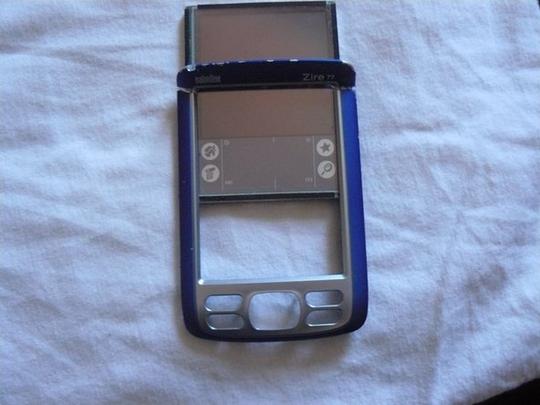

  2. Disassembling Palm Zire 72v1: crwdns2935265:05crwdnd2935265:01crwdnd2935265:02crwdne2935265:0 Disassembling Palm Zire 72v1: crwdns2935265:05crwdnd2935265:02crwdnd2935265:02crwdne2935265:0
    • Remove the two top screws.
    • Insert the tip of your screwdriver in the seam where the front frame meets the body of the unit and pry the frame up to pop it off. Remove it.

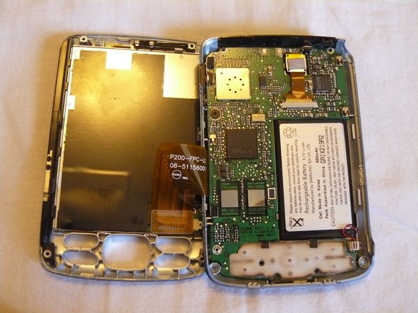

  3. Disassembling Palm Zire 72v1: crwdns2935265:07crwdnd2935265:01crwdnd2935265:01crwdne2935265:0
    • Pull the back panel off the body of the unit to expose the motherboard in the body.
    • Unplug the two orange ribbon cables at the top of the motherboard and remove the motherboard from the body. All that is left is the LCD screen in the front housing of the unit.
  4. Disassembling Palm Zire 72v1: crwdns2935265:09crwdnd2935265:01crwdnd2935265:01crwdne2935265:0
    • Remove the screen from the front housing and set it aside.
    • Now that you have your Zire open, you can remove and replace the defective part.
