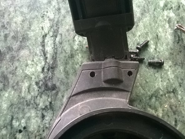

  2. Disassembling Over-Ear Headphone Sennheiser HD4199: crwdns2935265:02crwdnd2935265:01crwdnd2935265:02crwdne2935265:0 Disassembling Over-Ear Headphone Sennheiser HD4199: crwdns2935265:02crwdnd2935265:02crwdnd2935265:02crwdne2935265:0
    • By feel, locate 4 screws under the foam, 2 each side.
    • Scrap away just sufficient foam in order to be able to remove the screws, and remove them.

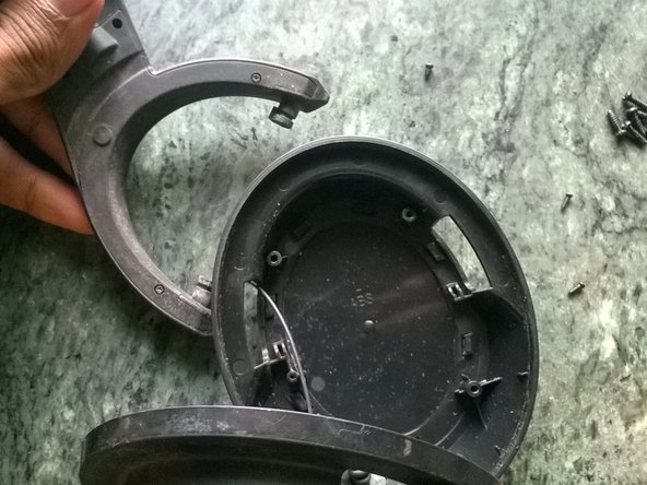

  3. Disassembling Over-Ear Headphone Sennheiser HD4199: crwdns2935265:03crwdnd2935265:01crwdnd2935265:02crwdne2935265:0 Disassembling Over-Ear Headphone Sennheiser HD4199: crwdns2935265:03crwdnd2935265:02crwdnd2935265:02crwdne2935265:0
    • The speaker assembly is now held in the shell just be a number of tabs around the edges. Gently prise it out from these tabs and remove it.
    • Take care not to strain the wires.
    • On reassembly, make sure the headband fork is correctly positioned otherwise it will be impossible locate the speaker faceplate correctly in the shell.
    • Also on reassembly, make sure the speaker face plate is secured behind all the tabs.

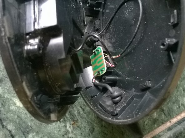

  4. Disassembling Over-Ear Headphone Sennheiser HD4199: crwdns2935265:04crwdnd2935265:01crwdnd2935265:02crwdne2935265:0 Disassembling Over-Ear Headphone Sennheiser HD4199: crwdns2935265:04crwdnd2935265:02crwdnd2935265:02crwdne2935265:0
    • On the right side connection are made via a small printed circuit board. Remove 2 screws in order to remove this for re-soldering or replacement of any of the wires.
    • On replacing this circuit board, take care to ensure that it's both the right way round and the right way up
    • If you are replacing the main lead with the jack plug on the end, make sure that you have suitable strain relief to prevent the lead pulling on the soldered connections.
    • The wire colours are:
    • Right: Red
    • Left: Green
    • Common (Ground): Gold.
