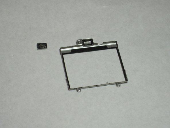

    1. Disassembling Nokia E61i Speaker, Speaker: crwdns2935265:08crwdnd2935265:01crwdnd2935265:02crwdne2935265:0 Disassembling Nokia E61i Speaker, Speaker: crwdns2935265:08crwdnd2935265:02crwdnd2935265:02crwdne2935265:0
      • Remove the speaker by pulling it off of the display frame.
      • The speaker is connected to the display frame by a ring of adhesive foam (visible in second picture). By removing the speaker, this foam is torn. However, the speaker sticks quite well to the frame without reapplication of any adhesive.
