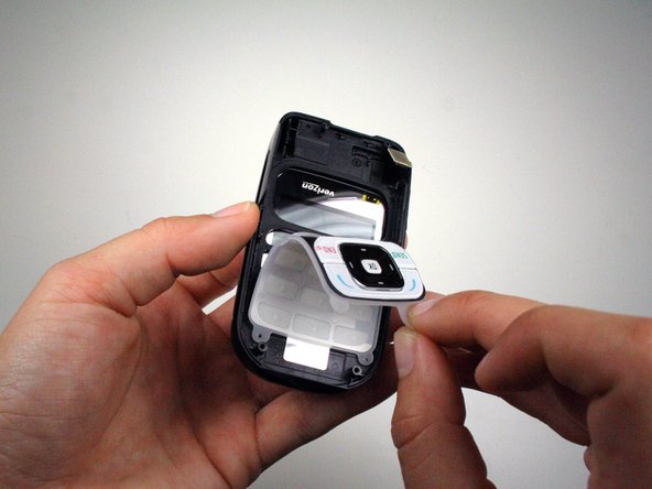

    1. Disassembling Nokia 2366i Keypad, Keypad: crwdns2935265:010crwdnd2935265:01crwdnd2935265:01crwdne2935265:0
      • Place key pad in view.
    2. Disassembling Nokia 2366i Keypad: crwdns2935265:011crwdnd2935265:01crwdnd2935265:02crwdne2935265:0 Disassembling Nokia 2366i Keypad: crwdns2935265:011crwdnd2935265:02crwdnd2935265:02crwdne2935265:0
      • Use your fingers to remove the keypad by carefully pulling from the top of the phone towards the bottom of the phone.
