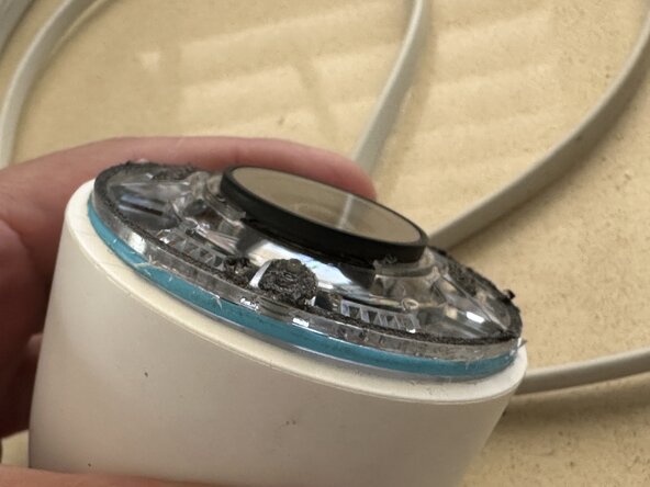

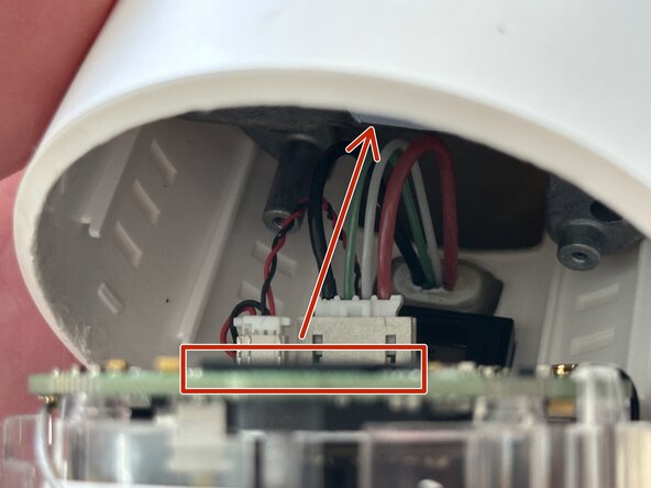

  2. Disassembling Nest Outdoor Camera, Inner camera body removal: crwdns2935265:02crwdnd2935265:01crwdnd2935265:03crwdne2935265:0 Disassembling Nest Outdoor Camera, Inner camera body removal: crwdns2935265:02crwdnd2935265:02crwdnd2935265:03crwdne2935265:0 Disassembling Nest Outdoor Camera, Inner camera body removal: crwdns2935265:02crwdnd2935265:03crwdnd2935265:03crwdne2935265:0
    • With a think Philips screwdriver, remove the four screws.
    • With the metal spudger, work it in between the white plastic housing and the clear body to raise the clear body out. Careful to not damage the blue o-ring.
    • With the inner body loose, carefully disconnect the speaker connector and USB connector from the PCB.
    • Note the two thermal pads for the chips on the PCB may remain on the heat sink.

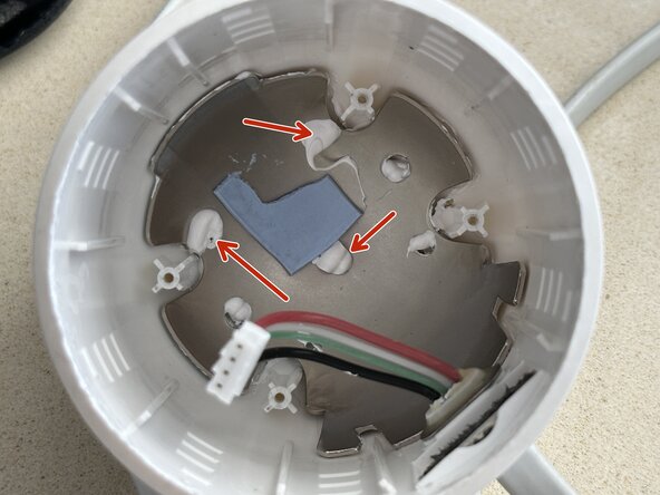

  3. Disassembling Nest Outdoor Camera, Heatsink removal: crwdns2935265:03crwdnd2935265:01crwdnd2935265:02crwdne2935265:0 Disassembling Nest Outdoor Camera, Heatsink removal: crwdns2935265:03crwdnd2935265:02crwdnd2935265:02crwdne2935265:0
    • The heat sink block is easily removed after the four Philips screws are removed.
    • Note that the heat sink has an additional thermal pad located on the back between it and cupped metal plate. Cupped metal plate seems to be another heat sink held in place with plastic stays and fluid thermal paste.

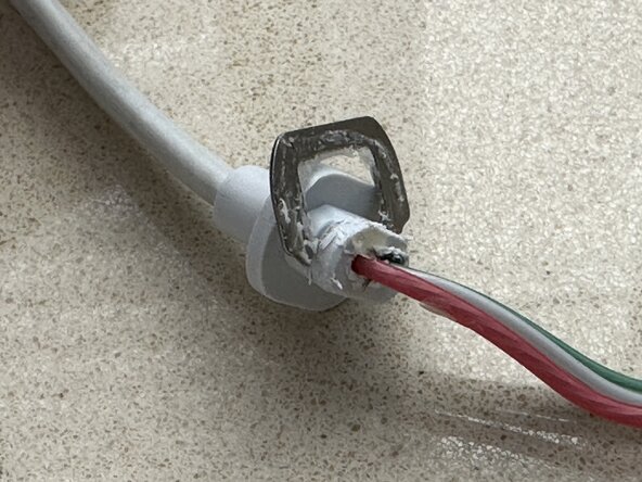

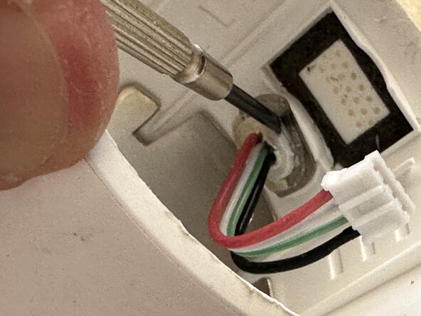

  5. Disassembling Nest Outdoor Camera, USB cable removal: crwdns2935265:05crwdnd2935265:01crwdnd2935265:03crwdne2935265:0 Disassembling Nest Outdoor Camera, USB cable removal: crwdns2935265:05crwdnd2935265:02crwdnd2935265:03crwdne2935265:0 Disassembling Nest Outdoor Camera, USB cable removal: crwdns2935265:05crwdnd2935265:03crwdnd2935265:03crwdne2935265:0
    • The USB cable is attached to the white plastic outer body by means of a plastic fixture that is help in place with a large metal c-clip.
    • The plastic fixture is covered in hot glue that must be scraped off.
    • Once the hot glue is removed, the c-clips can be slipped off.
    • With the c-clip removed, the plastic fixture can be pulled back out of the outer body. The 4 USB cable wires and connector can then be slipped out through the outer body opening.

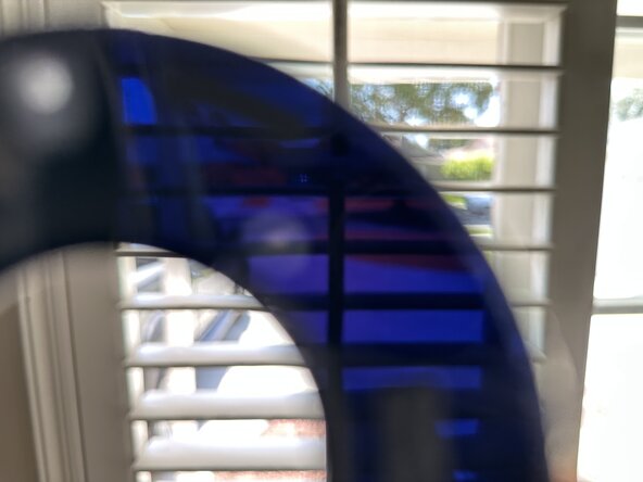

  6. Disassembling Nest Outdoor Camera, Disassembled camera parts: crwdns2935265:06crwdnd2935265:01crwdnd2935265:02crwdne2935265:0 Disassembling Nest Outdoor Camera, Disassembled camera parts: crwdns2935265:06crwdnd2935265:02crwdnd2935265:02crwdne2935265:0
    • Note the "black" front panel is actually a semitransparent dark blue.
