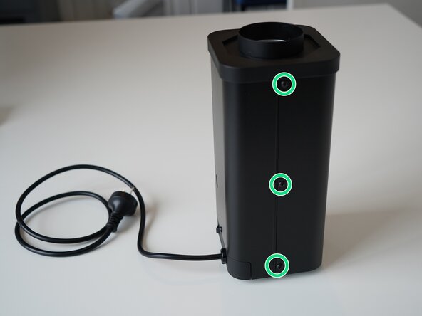

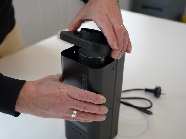

    • Remove the 6x 2.5mm Hex screws on the left and right side of the roaster.
    • Take care not to damage the buttons while maneuvering the front panel, with all six screws removed it may fall away.

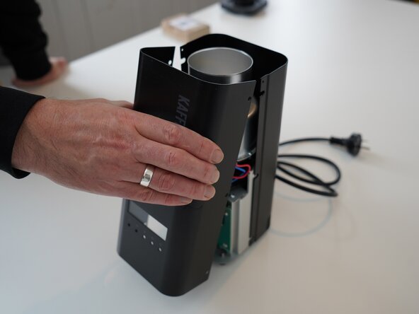

  2. Disassembling Nano 7/LINK (D-P Serial), Lift the closure: crwdns2935265:02crwdnd2935265:01crwdnd2935265:02crwdne2935265:0 Disassembling Nano 7/LINK (D-P Serial), Lift the closure: crwdns2935265:02crwdnd2935265:02crwdnd2935265:02crwdne2935265:0
    • Hold the front panel steady while removing the plastic top/closure.
  3. Disassembling Nano 7/LINK (D-P Serial), Removing the front panel: crwdns2935265:03crwdnd2935265:01crwdnd2935265:01crwdne2935265:0
    • Pull away the front panel carefully.

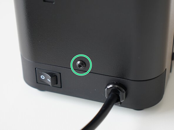

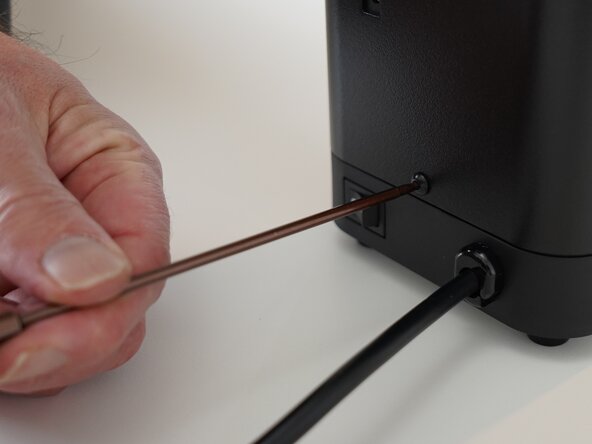

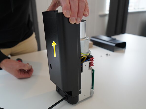

  4. Disassembling Nano 7/LINK (D-P Serial), Removing the rear panel: crwdns2935265:04crwdnd2935265:01crwdnd2935265:03crwdne2935265:0 Disassembling Nano 7/LINK (D-P Serial), Removing the rear panel: crwdns2935265:04crwdnd2935265:02crwdnd2935265:03crwdne2935265:0 Disassembling Nano 7/LINK (D-P Serial), Removing the rear panel: crwdns2935265:04crwdnd2935265:03crwdnd2935265:03crwdne2935265:0
    • Remove the last 2.5mm Hex screw securing the rear panel.
    • Pull up on the rear panel to remove it from the roaster.

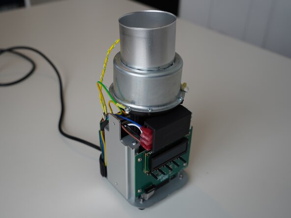

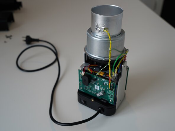

  5. Disassembling Nano 7/LINK (D-P Serial), Access granted: crwdns2935265:05crwdnd2935265:01crwdnd2935265:02crwdne2935265:0 Disassembling Nano 7/LINK (D-P Serial), Access granted: crwdns2935265:05crwdnd2935265:02crwdnd2935265:02crwdne2935265:0
    • Set the panels aside somewhere safe and bask in the beauty of your naked roaster.
