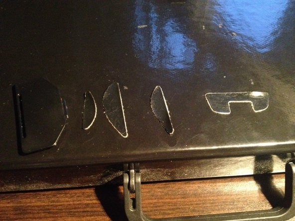

  4. Disassembling Mouse Buttons for Logitech Wireless Gaming Mouse G700: crwdns2935265:04crwdnd2935265:01crwdnd2935265:03crwdne2935265:0 Disassembling Mouse Buttons for Logitech Wireless Gaming Mouse G700: crwdns2935265:04crwdnd2935265:02crwdnd2935265:03crwdne2935265:0 Disassembling Mouse Buttons for Logitech Wireless Gaming Mouse G700: crwdns2935265:04crwdnd2935265:03crwdnd2935265:03crwdne2935265:0

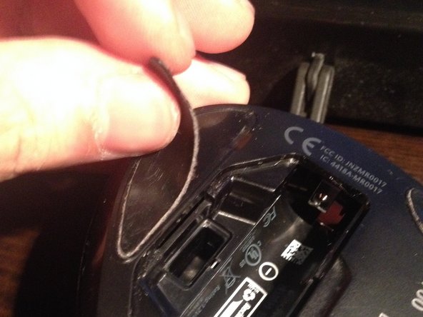

    • Peel off the four sticker pads located on the bottom of the mouse. They will be on the top, bottom and sides.
    • Stick these pads onto a clean, flat surface for safe keeping as you continue to disassemble the mouse.

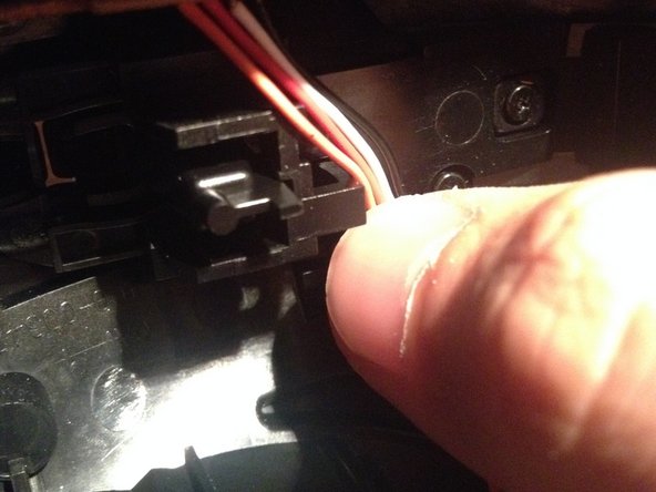

  7. Disassembling Mouse Buttons for Logitech Wireless Gaming Mouse G700: crwdns2935265:07crwdnd2935265:01crwdnd2935265:03crwdne2935265:0 Disassembling Mouse Buttons for Logitech Wireless Gaming Mouse G700: crwdns2935265:07crwdnd2935265:02crwdnd2935265:03crwdne2935265:0 Disassembling Mouse Buttons for Logitech Wireless Gaming Mouse G700: crwdns2935265:07crwdnd2935265:03crwdnd2935265:03crwdne2935265:0
    • Gently detach the four wires from the holder of the housing.
    • View: Underneath housing

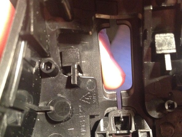

  10. Disassembling Mouse Buttons for Logitech Wireless Gaming Mouse G700: crwdns2935265:010crwdnd2935265:01crwdnd2935265:03crwdne2935265:0 Disassembling Mouse Buttons for Logitech Wireless Gaming Mouse G700: crwdns2935265:010crwdnd2935265:02crwdnd2935265:03crwdne2935265:0 Disassembling Mouse Buttons for Logitech Wireless Gaming Mouse G700: crwdns2935265:010crwdnd2935265:03crwdnd2935265:03crwdne2935265:0
    • Gently pry the lock holding both mouse buttons.
    • View: Underneath housing (still one piece)

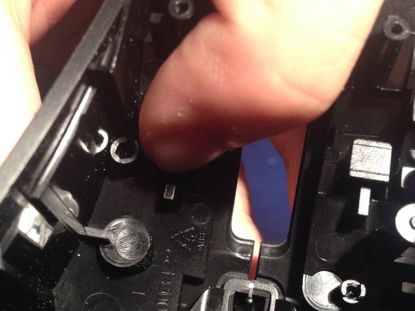

  11. Disassembling Mouse Buttons for Logitech Wireless Gaming Mouse G700: crwdns2935265:011crwdnd2935265:01crwdnd2935265:03crwdne2935265:0 Disassembling Mouse Buttons for Logitech Wireless Gaming Mouse G700: crwdns2935265:011crwdnd2935265:02crwdnd2935265:03crwdne2935265:0 Disassembling Mouse Buttons for Logitech Wireless Gaming Mouse G700: crwdns2935265:011crwdnd2935265:03crwdnd2935265:03crwdne2935265:0
    • Gently pry away the upper part of the housing.
    • View: Housing divided into two pieces: top and middle

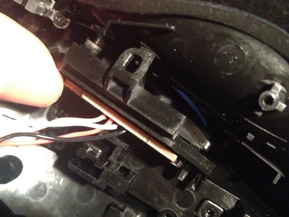

  12. Disassembling Mouse Buttons for Logitech Wireless Gaming Mouse G700: crwdns2935265:012crwdnd2935265:01crwdnd2935265:01crwdne2935265:0
    • Unscrew the two screws holding the part that locks the function buttons.
    • View: Underneath middle housing
  13. Disassembling Mouse Buttons for Logitech Wireless Gaming Mouse G700: crwdns2935265:013crwdnd2935265:01crwdnd2935265:02crwdne2935265:0 Disassembling Mouse Buttons for Logitech Wireless Gaming Mouse G700: crwdns2935265:013crwdnd2935265:02crwdnd2935265:02crwdne2935265:0
    • Slowly remove the plastic part you just unscrewed.

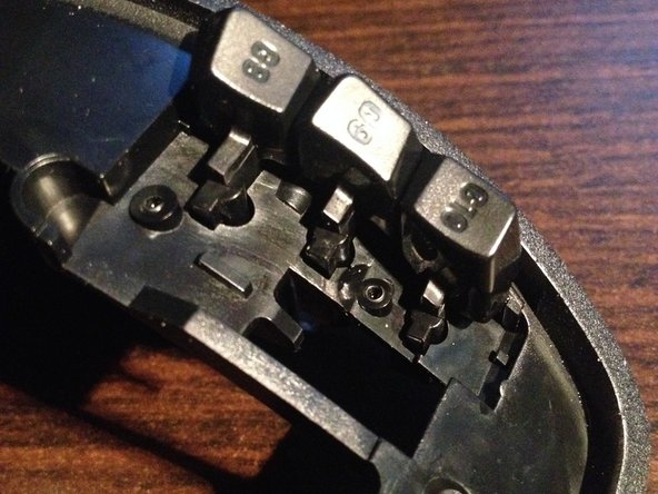

  14. Disassembling Mouse Buttons for Logitech Wireless Gaming Mouse G700: crwdns2935265:014crwdnd2935265:01crwdnd2935265:01crwdne2935265:0
    • Carefully pull each button towards you.
    • Do not misplace the small springs attached to the buttons.
