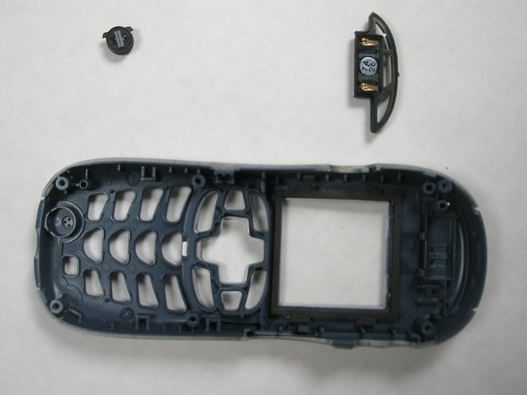

  13. Disassembling Motorola i265 Speaker and Microphone, Speaker and Microphone: crwdns2935265:013crwdnd2935265:01crwdnd2935265:01crwdne2935265:0
    • Locate the speaker (indicated in orange) and the microphone (indicated in yellow).
  14. Disassembling Motorola i265 Speaker and Microphone: crwdns2935265:014crwdnd2935265:01crwdnd2935265:01crwdne2935265:0
    • To remove the microphone, locate the two small tabs on either side of it.
    • Use the pointed end of the spudger to lift one of these tabs. This should lift the microphone out of the casing.
  15. Disassembling Motorola i265 Speaker and Microphone: crwdns2935265:015crwdnd2935265:01crwdnd2935265:02crwdne2935265:0 Disassembling Motorola i265 Speaker and Microphone: crwdns2935265:015crwdnd2935265:02crwdnd2935265:02crwdne2935265:0
    • The design of the speaker includes several cavities.
    • To remove the speaker, slide the pointed end of the spudger into one of the cavities and under the frame of the speaker. This should pop it out of casing.
